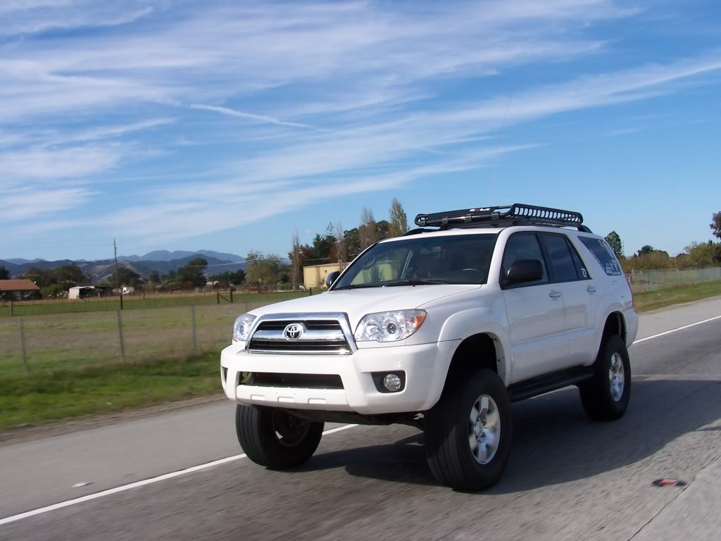

okay just for the hell of it i have decided to lift my 2wd 4runner as big as i flippin can.... aka i want to copy crazydubman. but i dont want to buy thousand dollar spindles. is it possible for me to buy 3 inch front lift springs and then put daystar top out spacers on top because i dont have to worry about CV's. then for the rear 3 inch coils with some 2 inch spacers. is this possible for the front??? i know the rear can be done but what about the front? thanks
here is crazydubman's... and i know with the tires i gotta do the body mount chop

I'll take a shot... I think you'd be ok, maybe. Once you go above 3-3.5" many of the guys end up changing the UCA's. The issue becomes alignment. Once you go above about 3" you have trouble getting the caster/camber specs where they need to be for proper tire wear and handling. Many of the T120 people use aftermarket UCAs for 2 reasons: 1) Better clearance for the big rubber 2) Allow the lifted ride to be aligned.
I agree with your spindle logic, you don't have the some of the issues the 4wd folks have.
Your idea of tall springs and some top-spacers doesn't sound bad to me for your intended use and price-point. Be aware you may have alignment issues and as I said it seems to become an issue as you go over 3-3.5" of lift.
