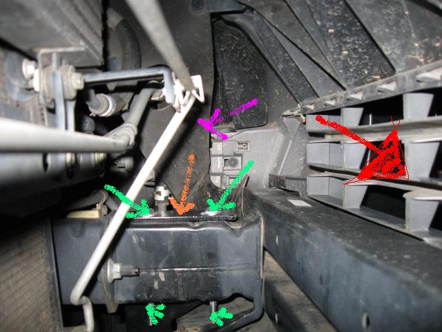

yes i did use two per bracket and im about to go outside to take pics now. u didnt get any directions?????????
here is the best pic of the driver side mount...
Red= Front of bumper
Lime Green= are the bolts, nuts washers that i had to buy. the bolt is fully threaded and is a 5/16x5 hex bolts, nuts and washers
Orange= is the bracket resting on top of the frame
Purple= is a flap that i had to take off the bottom holes. i put it back on after install. mine had the flap hooked on with some platic caps that i pried off.

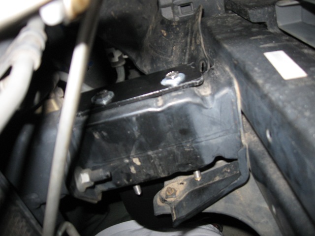

here is how it looks with the flap back down after install... this is passenger side though they both have the flap the 5/16x5 hex bolts were really pushing it though as u notice how close the bolt is to the bottom of bumper

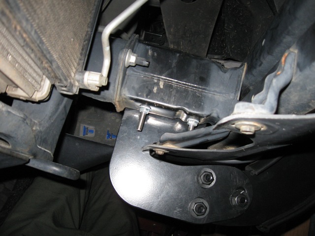

in this pic i held the camera way up into the bumper to get an overhead shot...

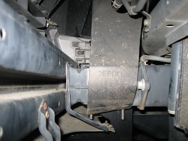

the whole shabang... driver side again, and take notice that the bull bar mounts are on the outside of the brackets.
hope this really helps.
