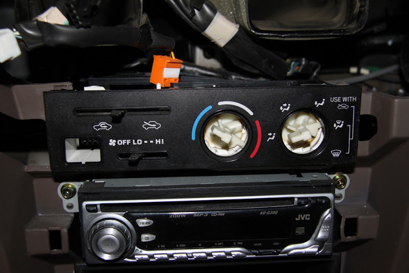

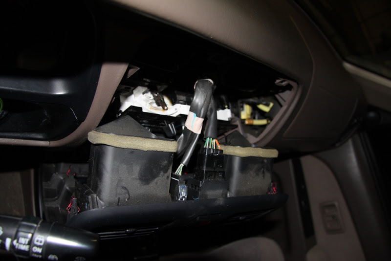

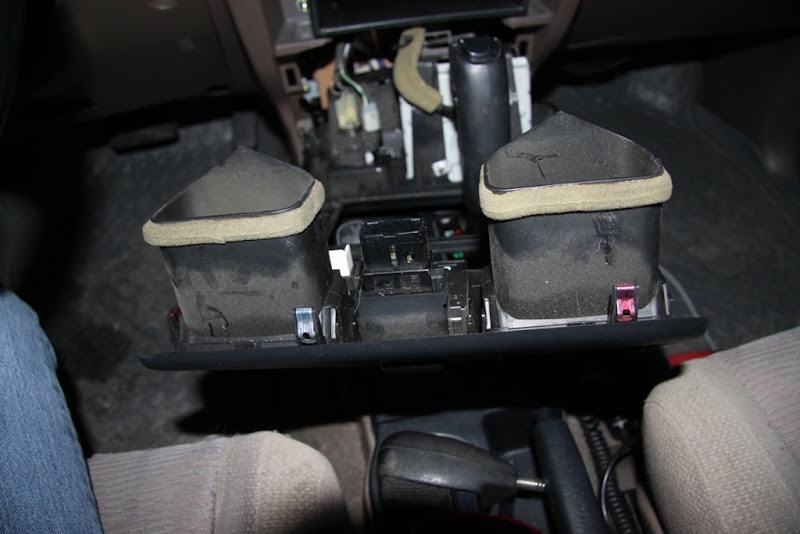

Pull the trim off gently, starting at the top, it is held on by clips, no screws or bolts.
Unplug the 4 connectors and keep pulling out and down with the trim.
Pull all of the knobs off the heater ac control unit, then pull gently on the plate behind the knobs.

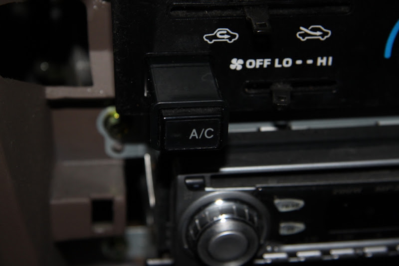

The AC button will just slide out with the faceplate pull on the plate on that side and slide the AC switch out.

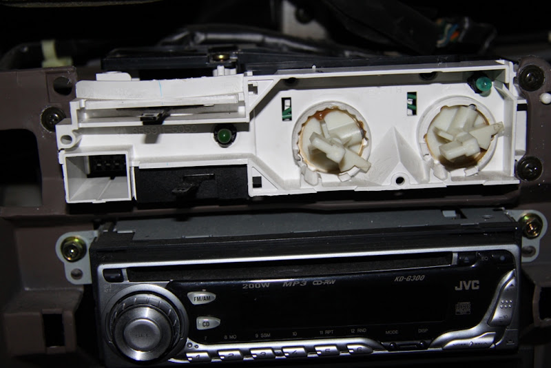

Pull the plate the rest of the way off and look at the bulbs with the green covers, they pull out from the front.
These are fairly common bulbs to buy BUT the green rubber covers that are on them are not available at parts stores. Sometimes you can re use them, but they can stick to the bulb and you will ruin them trying to change them. If you do want to change the color if the light, the bulb number is a #74. If you prefer to keep the stock color, do yourself a favor and buy the 2 bulbs from Toyota, they are around $3 each.
Replace them and snap everything carefully back in place!
