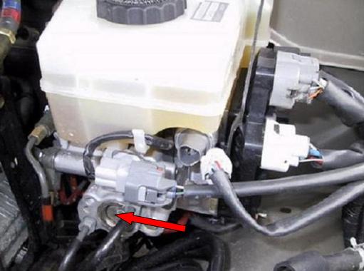

No issues first two weeks but noticed a small stain on my driveway under engine compartment. Contacted the dealer (Ford), and they asked I bring it in (they are working with me). They diagnosed it to the Hydraulic Control Unit (HCU), which appears to me to the be the master cylinder + other functionality. They can see the fluid being pushed out of the front of the unit when the brakes are depressed, thus the stains/puddles under my truck (ran down frame rail, dropped to ground...).
Curious...they noted the new part from the dealer to be $2,000, but they found a used one for ~$300 (which I'm OK with, as they stated it came off a vehicle with 50K miles, sure I'm trusting). Is this the true price? I did some Googling and couldn't find much (read anything) about replacing a HCU on a 4 runner. Is it mis-diagnosed? Should I be telling them to look elsewhere?

wanted to include an image of where (according to the dealer) the leak is coming from (attached):

If I remember correctly I think the ABS is integrated into that too which would explain the high price of it from the dealer, but I would have to look under my hood and double check. Nothing really goes wrong with my truck (knock on wood LOL) so I don't look under the hood much. Mine is an 02 SR5 2WD.
from my reading...yes, the ABS control is integrated into this unit. To update, the dealer called today and noted that they were having issues bleeding the brakes (after used unit was installed). Tomorrow will be day 4 in the shop. Thank goodness they gave me a Ford Focus to drive during the process:p
Conclusion: the dealer installed the used HCU, and so far (2 days) no leaks. They were decent about it, but I had to split the cost. Out the door @ $272. Could have been worse.
