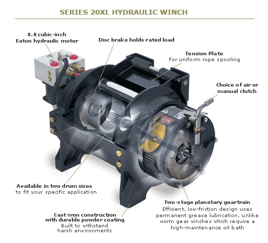

I did a little reading into this and found this Warn hydraulic winch...
This is the type of hydraulic winch that will trump any other winch as it uses an independant hydraulic motor opposed to the valve controls that rely on the steering pump as in the case of the Milemarker winch. Here there are no vlaves just a swash plate or something very close to it. There has to be a safety valve inside that would let go at around 300 bar allowing the oil inside to circulate keeping constant pressure at all times under excessive load. Thats when this type of pump is likely to overheat if abused.
Edit: safety valve is set for 206Bar/3000psi and its a 20,000lbs winch
From hat I've been reading, a "proper" hydraulic winch is used for equipment alot bigger and heavier then a 4runner. I just don't know that tapping into the steering system is such a great idea, if something does go wrong with it, you got no steering and then it really doesn't matter how stuck you are, your not getting home any time soon.
