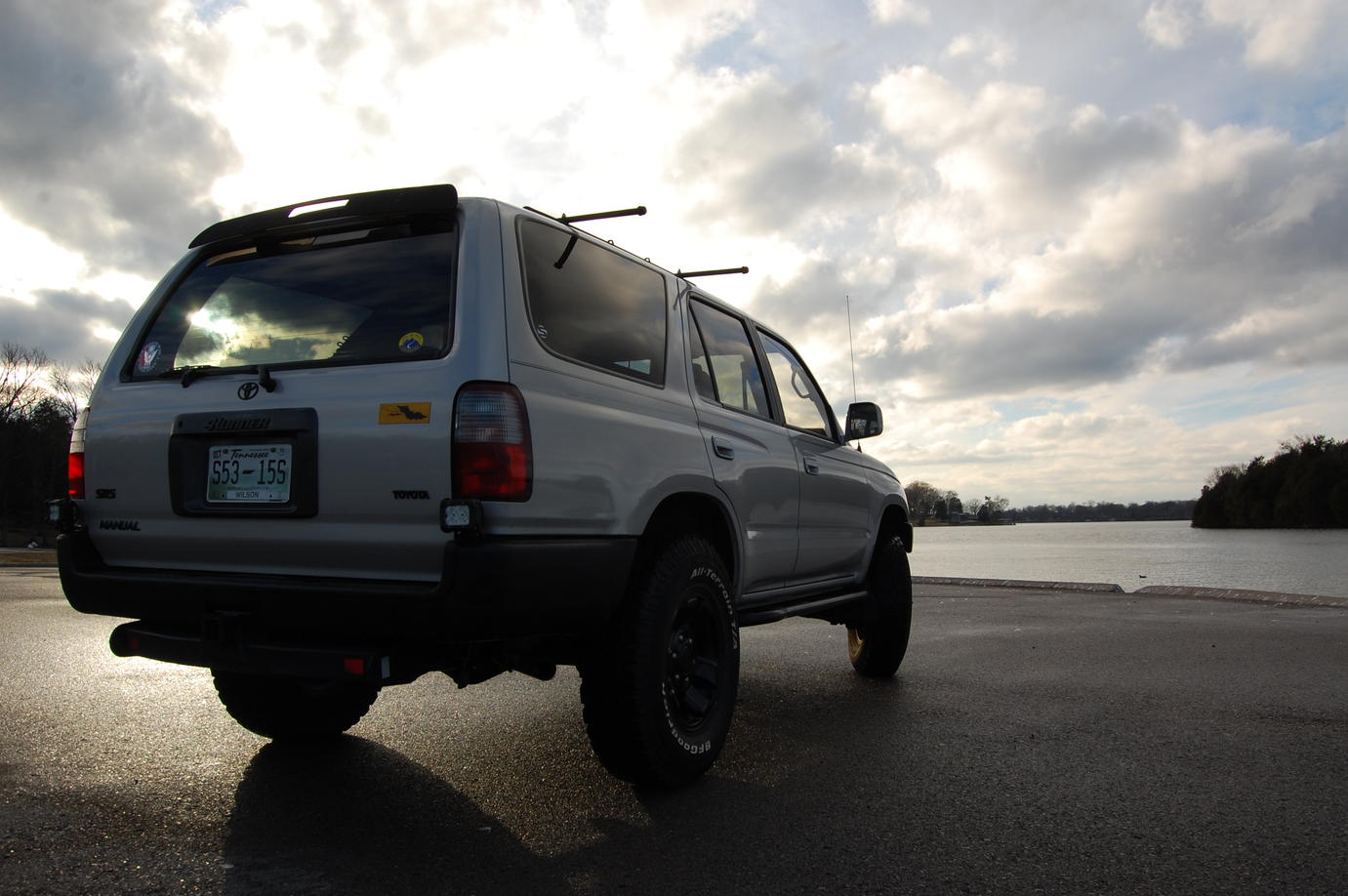

That's awesome! I just made mine out of some galvanized pipe that's painted black. Mine uses the factory tracks and are kinda hard to adjust with the bolts/washers I have jammed in them.
If I didn't already have the Yakima bars in my garage I would definitely use electrical conduit or some other pipe and just spray it black.
How wide are your bars? I'm keeping my eyes open at worksites for some 1-1/8 conduit so I can make bars wide enough for two canoes sitting flat, rather than one flat and one sideways.
