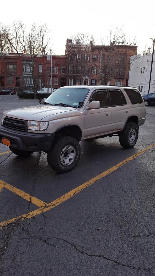

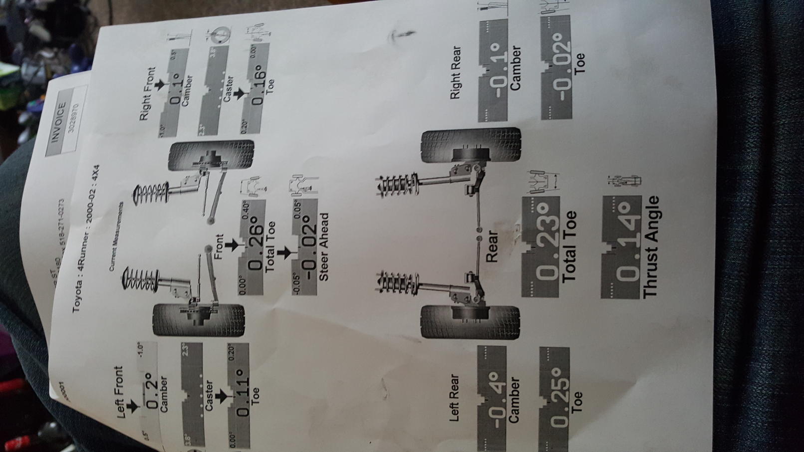

So I've lifted my truck, i wasted i set of 80% tires because the alignment was off. So today i go to get it realigned after i replaced my UCA's. Now they are telling my my inner tie end rods are too short to fix the toe correctly and on the highway i can barely keep it in the lane...

There is no caster reading on that report! And the Total toe is fine, so I don't know what they are talking about. Find a better shop!
yeah sounds to me like the shop doesn't have a clue what they are doing i just had my rig aligned today and i have stock tie rod ends and 3.5" of lift up front
