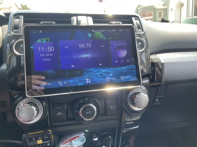

Here is what the 10.5” will look like if anyone is curious. Joying also just released their 13.3” rotating verticle/horizontal after I ordered my 11.6”
(Don’t mind the oem dash kit that I hacked up because I was going on a long distance trip and wanted to use the unit)

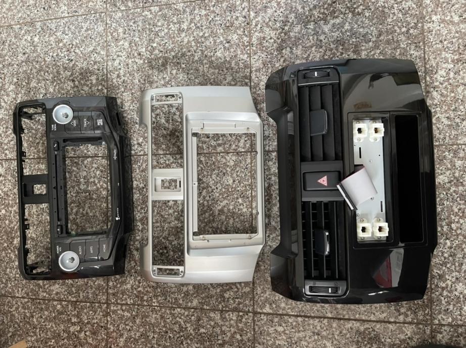

Pictures of the Oem dash, joying dash (silver) and metra (black) dash kit.
I was able to install the cubby on the bottom of the unit which will be covered after installing the screen. Sorta like a hidden compartment.

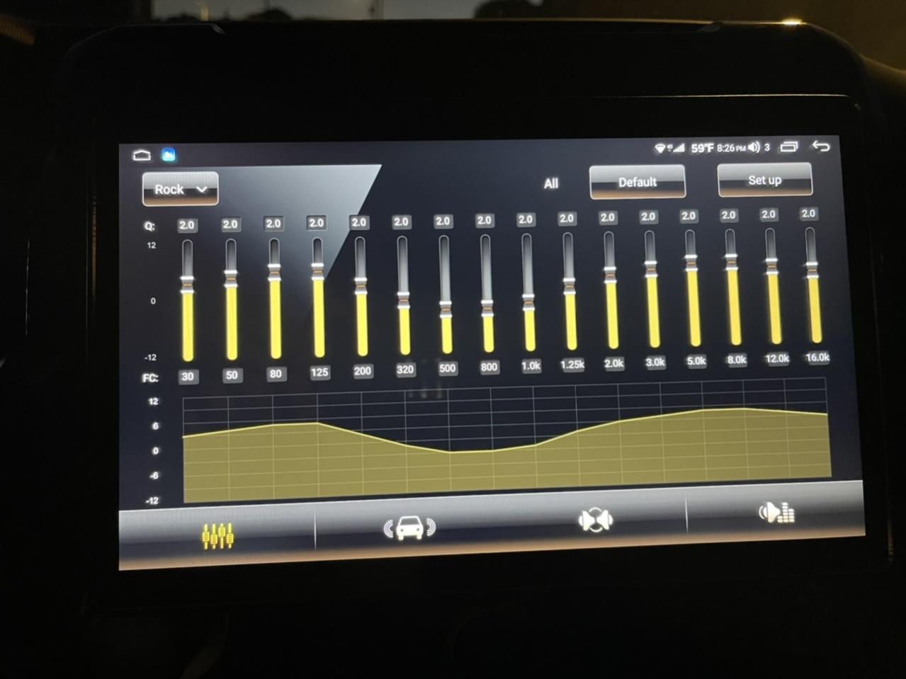

I don’t have JBL and I’m glad I don’t have it. There is an additional harness that you need if you have jbl. I think jbl uses some very low frequency, so when you change out the speakers, your system will sound horrible. The additional harness joying says they have to make jbl work. I would contact them about jbl system as I do not have any info on it.
Joying does have a built in digital sound processor tho.

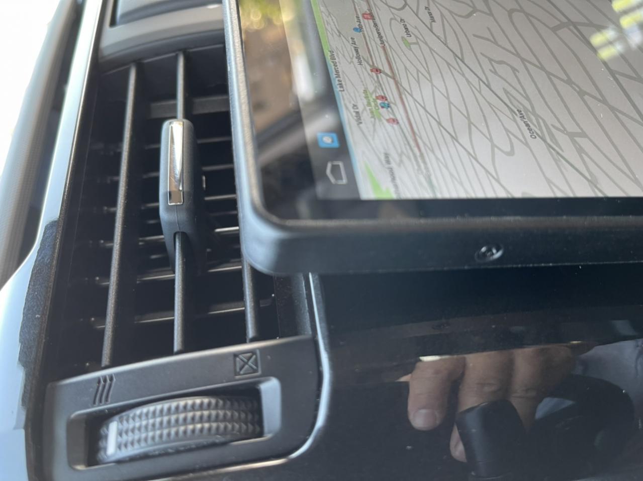

Does anyone have pics from the side? I'm kind of interested but it looks like it sticks out and blocks A/C vents and controls some. In AZ blocking the A/C vent, even a little bit, is a no-go. The A/C is borderline adequate in the summer already.
agreed, although ours kicks butt and will freeze you out. but i cant imagine blocking those vents

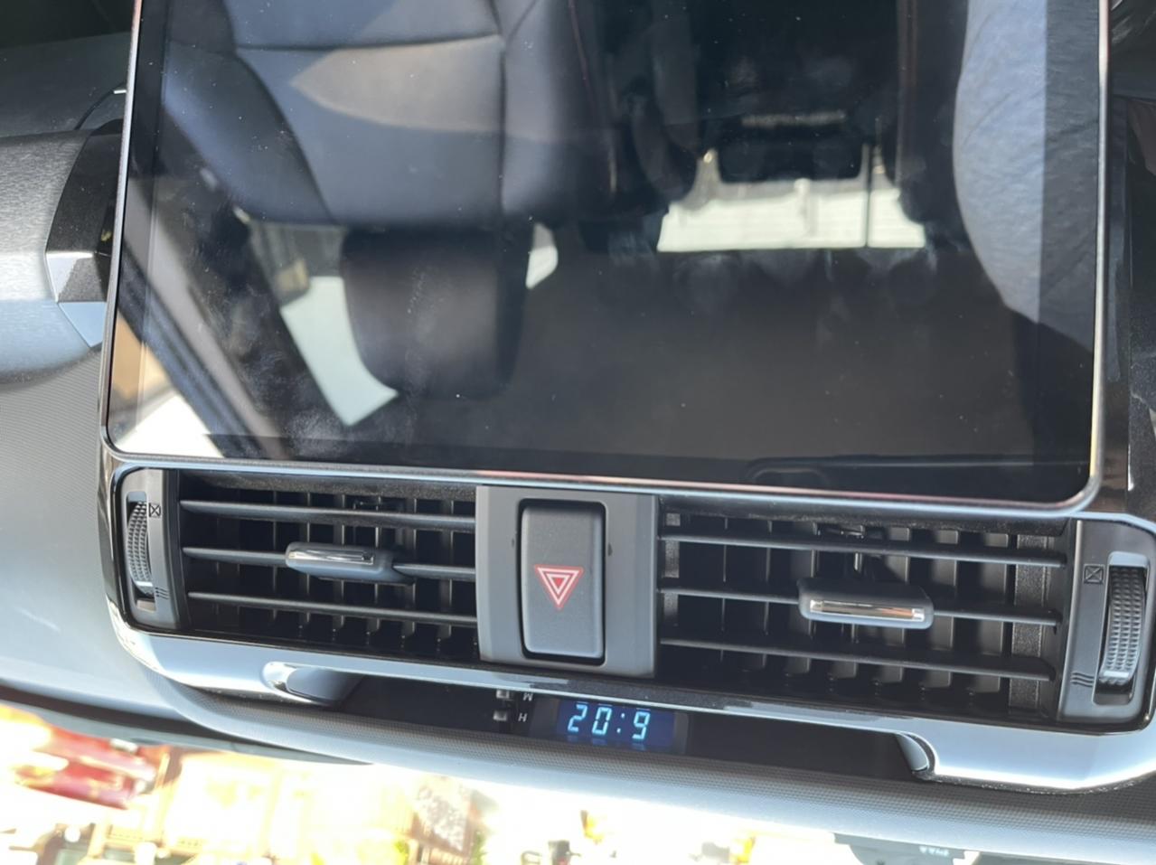

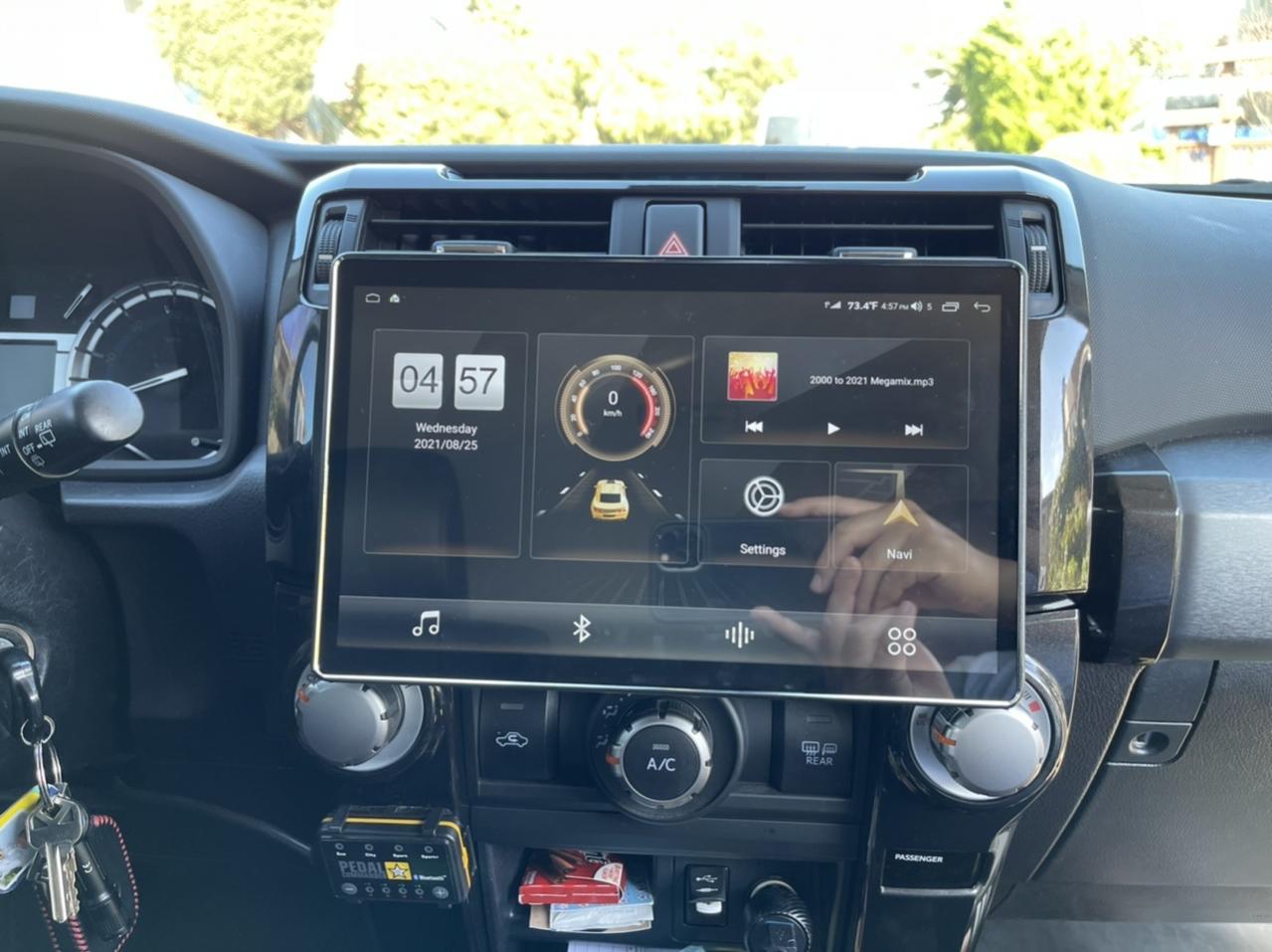

I can get a better picture later today. I’ll slap on the 10.5 screen also.
*The 11.6 screen just goes up to the bottom of the vent’s bottom horizontal trim.
The 10.5 will sit right under the vents.
