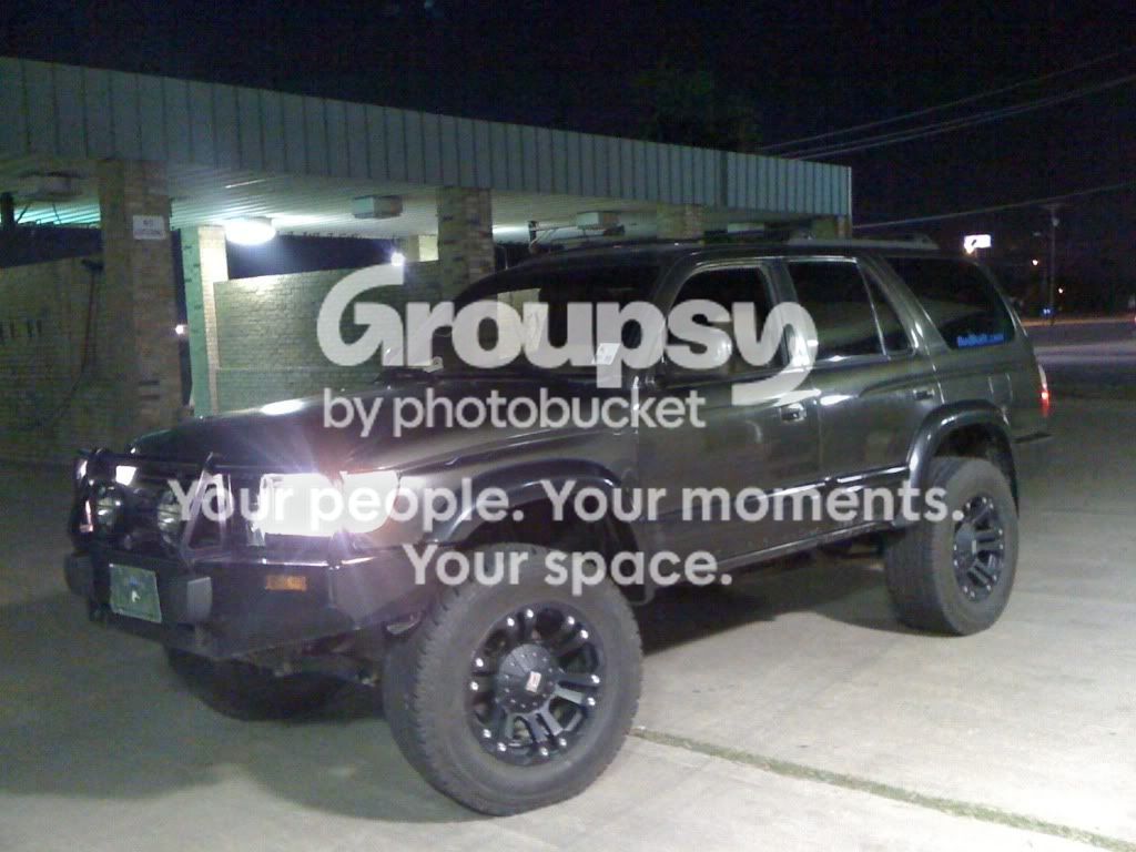

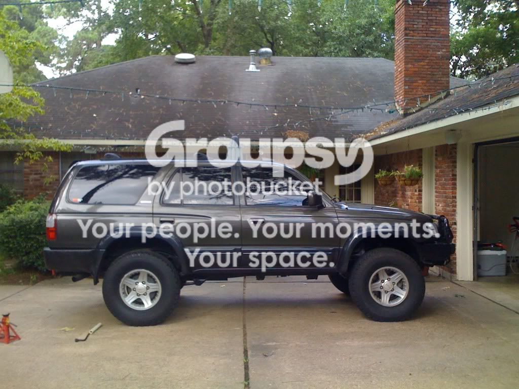

So right now im running 18" KMC xd series monsters with 285's. The tires are about to need to be replaced. I think im getting around 13 or 14 MPG. I was thinking about switching to stock 5 stars if i can find some and gettting some 285's from treadwright. Would switching from the 18's on 285's to stock 16's on 285's with more agressive tread (toyo AT's on the rims now, id switch to BFG AT's or MTR's on the stock rims) make a noticeable difference as far as gas milage? Just for looks heres a comparison

im kinda starting to think the rims make it look a little overdone anyways and i think itd look sick with 5 stars's.
