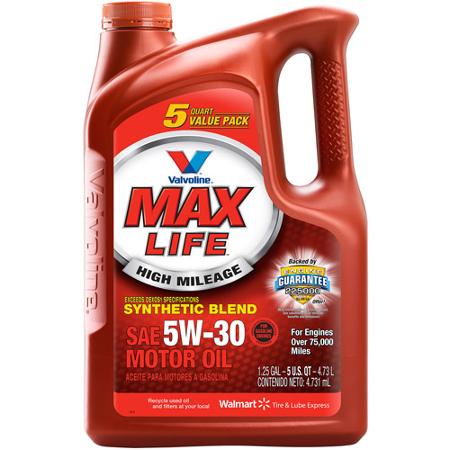

Valvoline max life, I never run anything else in my truck and it works like a charm!
