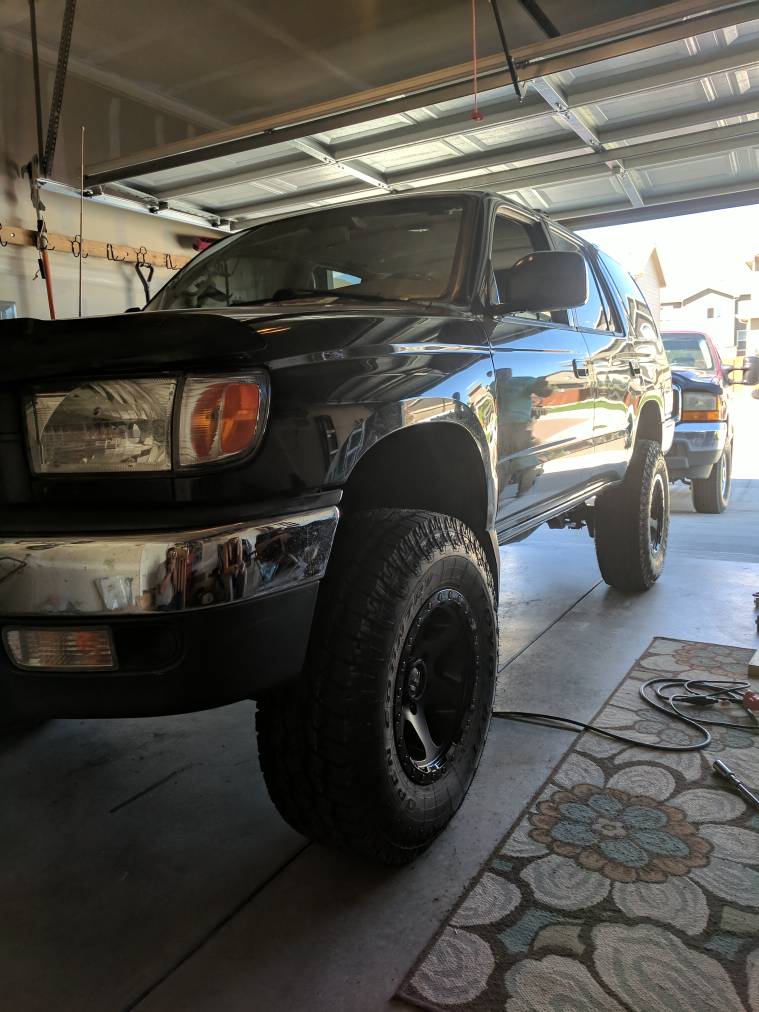

Just put my toytec lift in over the weekend. 3 inch and I couldn't be happier. New wheels and tires as well. I'm definitely a by the book protocol type of guy so I drove it right down the street for an alignment. Here comes the bad news go figure. "The driver side alignment went great but the passenger side has seized cam adjusters". Sweet. Just was I was hoping to hear.

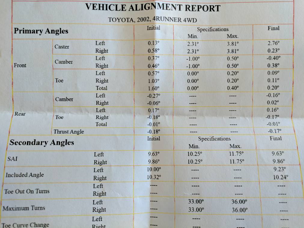

So where does this leave me? Shop wants $480 to make the repair which apparently involves a whole new lower control arm. Option two would be that I tackle it myself and cut the sleeves/bolts out and replace bushings with whiteline. I'm a fairly capable guy who can perform general maintenance, lift installation, timing belt changes. Never worked on the lower control arm and the only experience I have comes from Tim's video on Toyota time. Questions come to mind such as where exactly do I make the cuts? How do I get the seized sleeves and bushings out of the frame of the car once the control arm is removed?
Then there is option three. In reading through the forums the last few days I've seen people discussing new upper control arms which have a certain degree of alignment adjustability built into them. Is it crazy to consider replacing the upper control arm so that I can account for the alignment needs and make other gains in aftermarket off-road technology? Or do I need to correct the lower issue first and dabble with upper upgrades down the road? Appreciate the insight you guys offer in advance.

Even with new UCA's you'll still need to get the LCA fixed. A seized cam bolt basically means you can't align that side of the car. So even with UCA's you'll still not going to fix the problem or be able to get an alignment.
I replaced my LCA's a couple years. It was a PITA due to having to cut the cams out, but it was doable. My only advice to you is do BOTH sides, and change the bushings on both sides while you're at it. Keep in mind that once you remove the LCA, and put it back in. You're alignment is going to be way messed up. After I finished mine I couldn't get them adjusted enough to feel safe driving down the road, and ended up having it towed to the shop for the alignment.
Getting UCA's is a good option as well, but it doesn't sound like you're going to have alignment issues once the cam is fixed.
The cam bolts adjust camber right? If new UCAs have camber adjustment, why wouldn't new UCAs work? Maybe its so far out that the UCA can't bring it in spec at full adjustment - but OP never mentioned how far out it is?

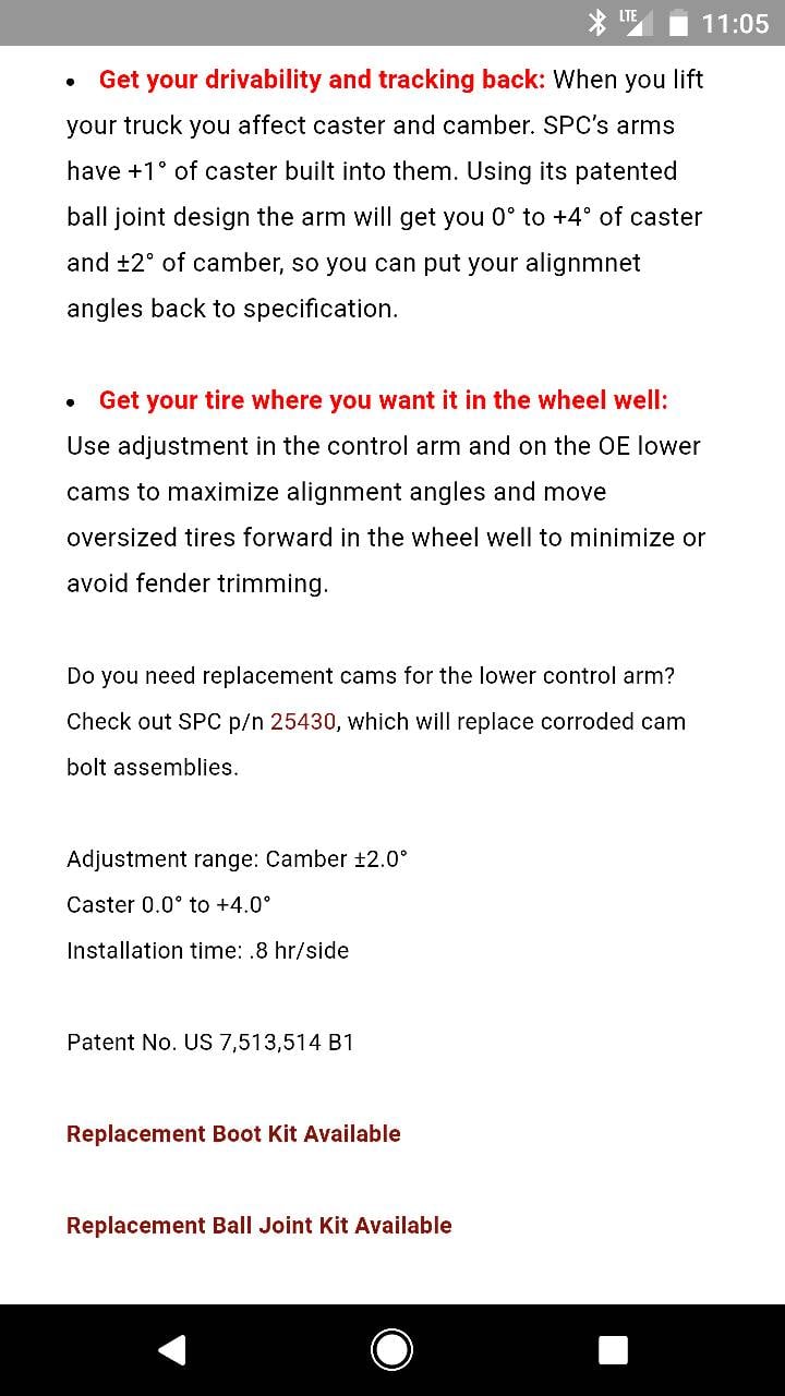

The UCA's like SPC's have adjustments but they are crude, not precise at all. You still need LCA's to fine tune the alignment.
Correct, those adjust the camber. New UCA's will give somewhere around 5* of additional camber to help allow alignment with a lift. Depending on how much he's off makes a big difference. The new UCA's could put him over the edge if it's only off by 2*. That being said, adding UCA's to gain camber in the this position would only be putting a band aid on the issue.

The spc arms can not be fine tuned for camber. You must lift the truck off the front tires, move the entire ball joint bolt and tighten it up. So its very crude and wont be able to fully align without the lower cam bolt adjustment. I'm sure an alignment shop would charge 1-2 hours labor just to adjust the SPC arms.

Success. Also lucked out a bit. Was able to pick up the lower control arm from a pull and pay this morning for $37. The lucky part came in as I was unable to find Whiteline bushings day of but a friend of mine had already purchased the exact set needed as he plans to do his in the near future. He gave me his and I just ordered a replacement set for him. Cut the old control arm out using the Diablo blades. Can't imagine using any other blade given the severity of the cuts that had to be made. These blades held up very well considering. Pretty sure I have every loaner tool the local O'Reilly Auto Parts store has in regard to pullers and presses. [MENTION=120071]mtbtim[/MENTION] the steering rack video which I originally watched a month ago came in very handy along with the lower control arm bushing replacement video. Me and my brother knocked it out step by step. The bottle jack trick went off without a hitch. Honestly find all of the videos invaluable. Doing the work myself also gives me the perfect opportunity to let the wife know about the new tools I need for my collection. She was even a team player and went out and picked up the specific sockets I was lacking to hit some tight spaces for the steering rack.
Both sides are put back together however the passenger side with the new lower control arm and cam adjusters is definitely turned to the right a bit. Plan on lifting the truck back up tomorrow and adjusting this as close as possible before driving to get an alignment two miles away tomorrow morning. Hopefully those two miles don't chew up my brand new rubber.
