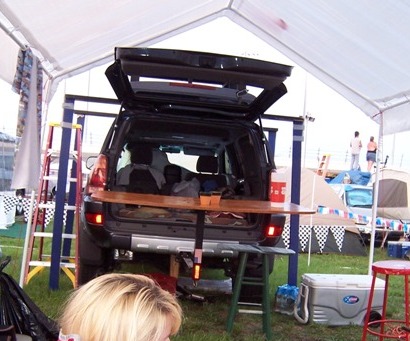

I use this rig for all kinds of stuff and it keeps getting better. A few years ago I made a table to use at the speedway for the races. It fit in the hitch and I made 3 different size tops. Here is a pix of the big one. They all have holes to fit a big beach umbrella. This is a pix from the 4th of July race.

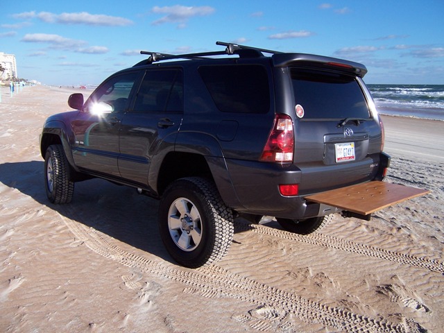

Well now I have been hanging in the back but have not needed a full table. I can sit up in the back but my head hits the top. I did not like how the back was unlevel and it was not too comfortable to sit on the bumper. I wanted a tailgate. So I had a hitch made that would hold a "tailgate" or piece of plywood. The wood sits on the back 2 inches of the bumper for suport and clears the liftgate.

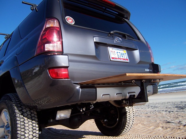

Pretty simple. Just had to make sure the metal platform was the same height as the bumper.

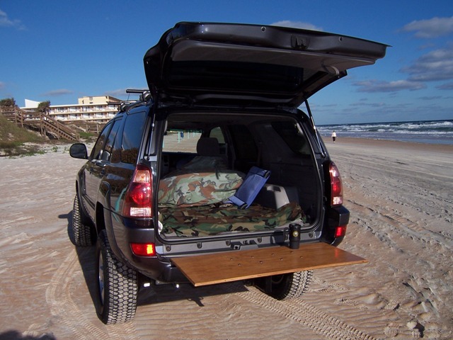

Should be perfect for the beach or camp. I think I can also use it as rack for some extra storage to save some room inside. Like for a cooler or something.
As for the wood; it's held in place with 8 low profile bolts and wing nuts. I used some regular untreated plywood and rounded the edge with a 1/2 round bit (top and bottom). Then I hit it with a cherry stain and then built it up with 3 coats of poly.

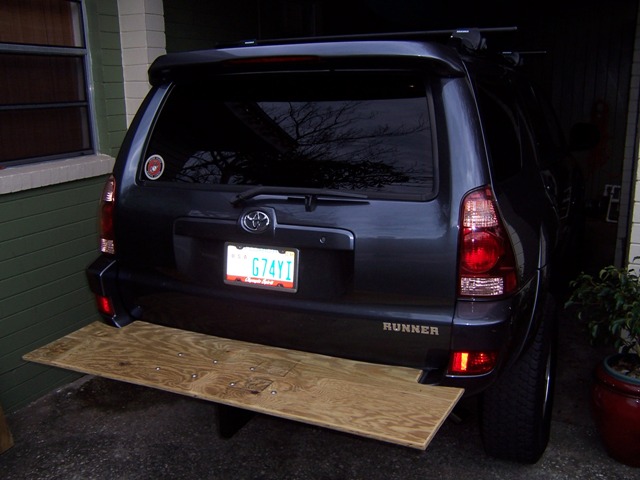

I was thinking outside the box on this one. Made out of 3/4 preasure treated plywood and kind of molded to the back and wider than the others? Turns out I like the ones that stick out more for sittin. If the one in the picture was 4 inches longer it would rock. Picky I know, but those 4 inches make it more comfortable to sit and lean back a bit. If I ever get a piece of wood the right size I'll make this one again with more depth and the width of the rig.
