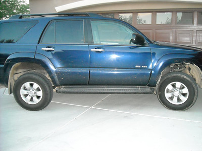

Ok, I just got an 08 4runner sr5, and i would like to level it out. I want to get rid of that factory look. any advice?
Stock

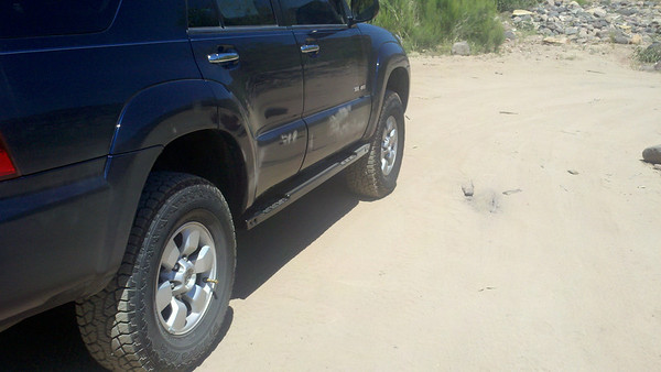

Slightly Modded
IMG_1141.jpg~original

• Daystar Spacer Lift 2.5/1.5 (Preload/Topout)
• P265/70R17 Bridgestone Dueler A/T Revos
...for now

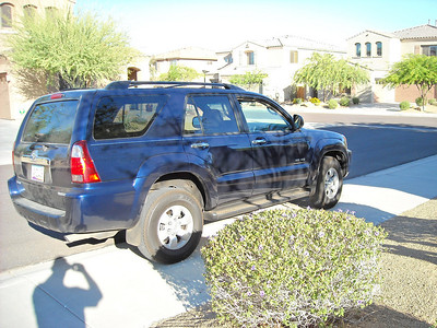

here is my 07 when I first got it:
then I installed a 3/2 Readylift and it looked like this with stock tires:
then I got some slightly larger tires and ditched the mudflaps and running boards:

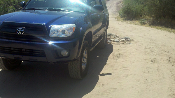

Then I wanted more so I got the adjustable Bilsteins and FJ springs (with some sliders):
I think the 3/2 levels it out really well, if you go up 2 or 2.5 in the front and leave the back alone you should be good. Or, you can get the adjustable Bilstein shocks and have 4 choices of front height. The install on the spacers is a little simpler than the shocks but either way you have to pull the front suspension apart and go for an alighnment when your done....
