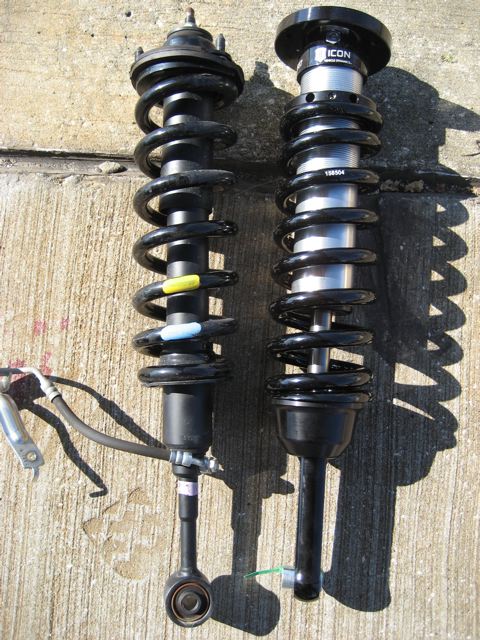

Looks like I was wrong on this (bad memory and it's late), they both have about the same length spring, but the coilover does have about 2" more space between the top most position of the collar and the bottom pearch over the stock struts top and bottom collars. And if you look, the springs in their current state they are apox the same length, but the coilover is already adjusted to have about 2.5" of lift out of the box.
I was going to post a similar pic. Most coilovers have approx same spring legnth. Long travel COs being the exception, but they have their own issues with more mods needed to use.
So looking at your pic, the overall strut legnth is longer but spring legnth near same. If the factory strut unit had a topout spacer it would be the same legnth and provide the same lift.
The coilover is stiffer and rightfully so, as with less space between each coil turn the coil would stack sooner otherwise.
