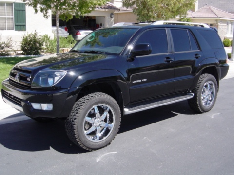

Alright, here's my problem -- I've had my heart set on getting a set of 20" Foose Speedster 6's wrapped in BF Goodrich All-Terrains (size 285/55R20). So I went down to talk to a local distributor and he says it shouldn't be a problem. Then it turns out that because of the backspacing on the rim, the wheel and tire combo won't fit without a wheel spacer, which by the way sounds pretty scary. I really want to put these 2 together, but he's saying (1) you can have the rim and tire together, but you need a spacer; or (2) you can have the rim and get a low pro tire and forget about the spacer.
So is there any way to know for certain which tire and rim you can put on your car without actually having to put them on. 'Cause I'm actually thinking aboug just buying them just to see if they'll fit or not. Please advise!

Is this what you are looking to do?
I believe this guy went with a 3" Cornfed Spacer lift (www.burtmanindustries.com) giving him enough room to work with 20" Foose rims and BFG AT KO tires. Can anyone back me up or correct me? (Preferably the badass who owns this 4Runner)

The reason why I say that is because that is actually my truck. I did decide to go with a 3" lift from Revtek and slapped on a set of 20" Foose's wrapped in BFG 285/55R20 All-Terrains. With this setup, there is just enough space behind the rim to clear to upper arm, although I did have to cut away a lot of the fender.

Will a Cornfed 3"/2" lift provide enough room for that setup?
~ I am worried about keeping my full turning radius...I work at a construction site (New Home Sales) and I don't do much off-roading. Moderate at best.
How do your BFG AT's hold up?
~ I have a highway commute to and from work...so I need a good life/wear pattern.
Brakes?
~ Did you have to upgrade your brakes to compensate for those 20" rims? Would you recommend it?
275?
If the 285's rub too much, Will the 275/45/20 BFG work with those rims?
Can you please send specs on the rims.....backspacing?
Thanks a bunch for the info. Any new pics?
I haven't taken any more pictures mainly because I haven't been anywhere interesting and the truck has been under some serious surgery (most of the interior panels have been removed and I have been driving without my climate controls for a little over a month now).
But to answer your questions:
1. The Cornfed lift should work, since the Revtek lift I am using is also rated as a 3/2 lift, according to their website. As for turning radius, you should not have a problem, so long as you are willing to trim off a lot of your inner plastic fender. From I have been able to tell, I still have my full stock turning radius without rubbing up against any other body parts.
2. I drive about 25 miles roundtrip everyday for work, with a mixture of both local and highway. I have only had the wheels on for a couple of months and have not noticed any significant wear and tear. They look like they are holding up real well and I do not think I have lost any ride quality (that is by my standards). Also, they do not make as much noise on the highway as mud-terrains. Plus, BFG's are known to last forever. I remember I had a set of low-profiles on my old rice rocket, and they almost never seemed to wear out even after all the burn outs and drifts I pulled.
3. I have not upgraded the brakes, although that is always a good idea (and costly, as well). I have noticed that the truck is a lot heavier and so I have had to compensate with more time to apply my brakes comfortably. But again, it is nothing significant.
4. Honestly, I do not think my 285's rub that much at all, if any. So I would say go with the 285's -- they fill the wheel well a lot better and just look meatier (again, this is just my opinion).
5. As for specs about the rims, unfortunately all I know is that they are 20x9.5 Foose Speedsters. I can't recall what the backspacing is, but I believe they only have one size for their 20's. So if they fit on mine, you shouldn't have a problem fitting them on yours.
I hope this helps. Please let me know if you have any other questions. I will post some more pictures once the next project is completed. Thanks for the interest!

I meant to ask, did you have to end up going with some sort of wheel spacer to run that setup? Also, what's the latest? Are you still liking your wheel/tire choice? Thanks.

Trik: I did not use a wheel spacer because I specifically did not want something wedged in between my rim and the hub -- just didn't feel right. I can see Casper's point in that they it's probably all in my head; but the fact that a friend of mine manufactures wheel spacers for trucks and suv's and even he won't use them, scares me a little.
I am still loving my tire and wheel combo. The suspension has started settling in a little more, so I have had to cut a little more of the fender and mudflap. But I love it still. Ride is good, turing radius is fine, noise is minimal -- really couldn't ask for more.
