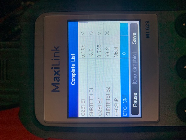

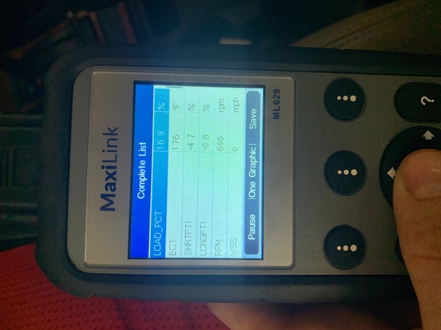

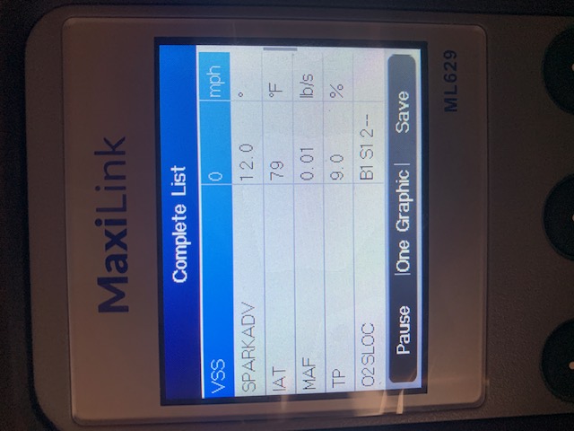

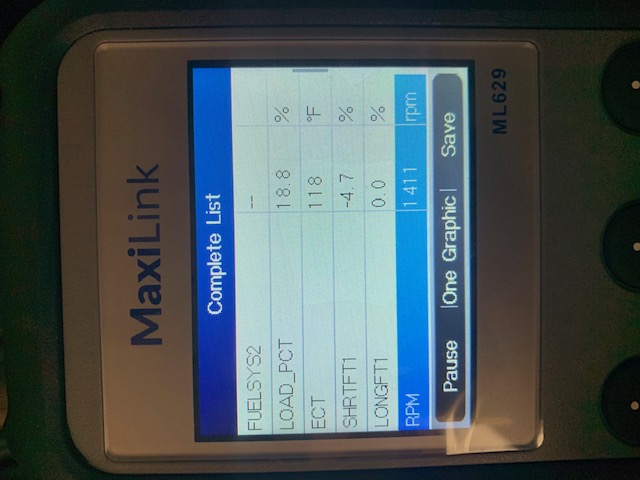

My 99 4runner had a leaky injector so i replaced the oring on it. since then i had high idle problems and lean bank 1 code, but it was running rich. I took everything back apart, had injectors serviced and cleaned, replaced intake manifold gasket and cleaned all in there, replaced upper and lower plenum gasket, replaced tb gasket, cleaned tb, and still when i start it, it high idles. after 5 min the idle drops but feels like its struggling a little. i attached the live read outs, any ideas.
thanks
The photo with 1400 idle is just after starting.
the photo with 680 idle is after about 5 minutes.
the other two are after warmed up as well
SORRY photos are sideways. don't know how to change now

Your 1400 high idle seem normal. Mines goes 1500 then settles at 700 (pending weather).

If you did this before the engine was at operating temp or within a couple minutes of restarting it when it was at/close to temp, then it's normal operation for the IAC. If your idle does not drop to 700 rpm +/- 50 rpm with the ac off once the engine is warmed up then you have an air problem. Not necessarily an IAC problem. 1500 rpm +/- 100 rpm is normal for warm up idle in park or neutral. This information is from a 2000 factory service manual.
