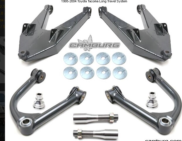

I need more front flex.
You're looking at about $2000 to $2500+ for the LT kits. (At least thats what google said after a quick search.) Trust me, if you budget $3500 for an SAS, you're going to get what you're look for as far as stuffing your tires, as well as more reliable offroad performance.

I'm also gonna look for a set of used UCA's from Camburg or AllPro and do a before and after RTI test...
