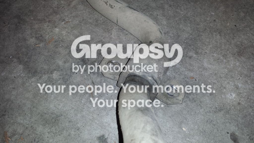

When I brought my 4Runner home after buying it, I realized that the front sway bar was inoperable. One of the endlinks had been broken and one of the bushing brackets was torn off the frame. So, questions for you...
1. Are these aftermarket, polyurethane bushings (see the picture)?
2. Can I simply buy a new metal bracket to mount the existing bushing up again or do I need to buy a whole kit?
3. Kinda important... If I need to buy a new set of bushings and brackets to make this work again, should I get the kit that does not have zerks, or the kit with greasable zerks? I thought I remembered in the past reading that the zerks used by ES were problematic, or some other complaint about them?
Here are the Greasable bushings
Here are Moog Non-grease bushings
Here is the bushing and bracket that are in tact. I have 1 other bushing but not the bracket for it.
It's hard to tell if those are polyurethane or not by the picture. I think you could tell by squeezing the bushing if it's rubber or polyurethane.
As for aftermarket sway bar bushing brackets, I think a greaseable bracket would be useless. What would you grease it with anyway, lithium grease or moly grease that you have in your grease gun for servicing the u-joints, sleeve yokes and double cardan joint? I used a tip from a guy who made a video on replacing his sway bar and end link bushings. He used Mission Automotive silicone paste to lubricate his poly bushings. I bought a container of it and have used it to lubricate my steering rack bushings, sway bar and end link bushings, and most recently, my rear shock bushings that I replaced with poly ones a couple days ago.

I think I'm right inline with your thoughts Tim :) ... I bought an OEM replacement bracket for the one that was broken. I found out that it doesn't fit the bushing that is there, so I can't use it.

Hence why Energy Suspension has ones that you can lubricate. I have those on mine since my bushings were shot, I do have to say the brackets are sub-par compared to the Toyota brackets though. I had one bend out of shape once.
Ive torn through two ES brackets, they are trash. Also the zerk fitting does nothing, no grease gets into the bushing through the zerk. Go with OEM brackets.
