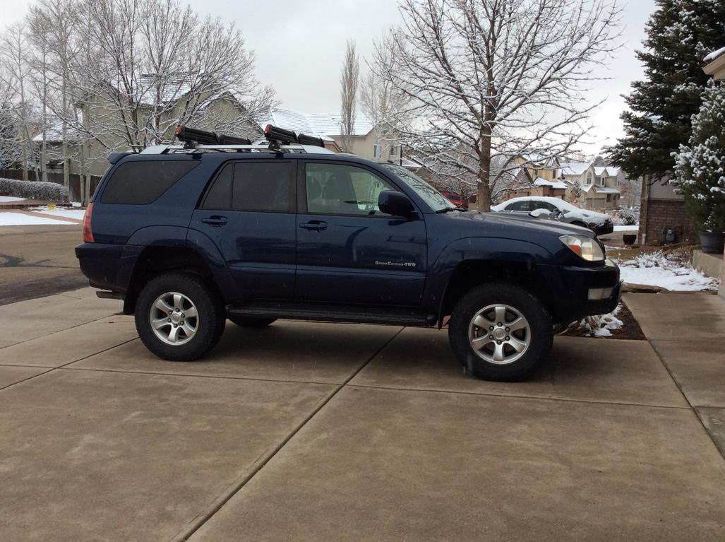

I got close to 3 with 885's on my 04 V8

Stock weight those should both net you about 3"
On a V6, the 885 may give you a little bit more. I am running the 885s with the V8 and a bumper and am about 2.5" estimated (don't have stock measurements)
