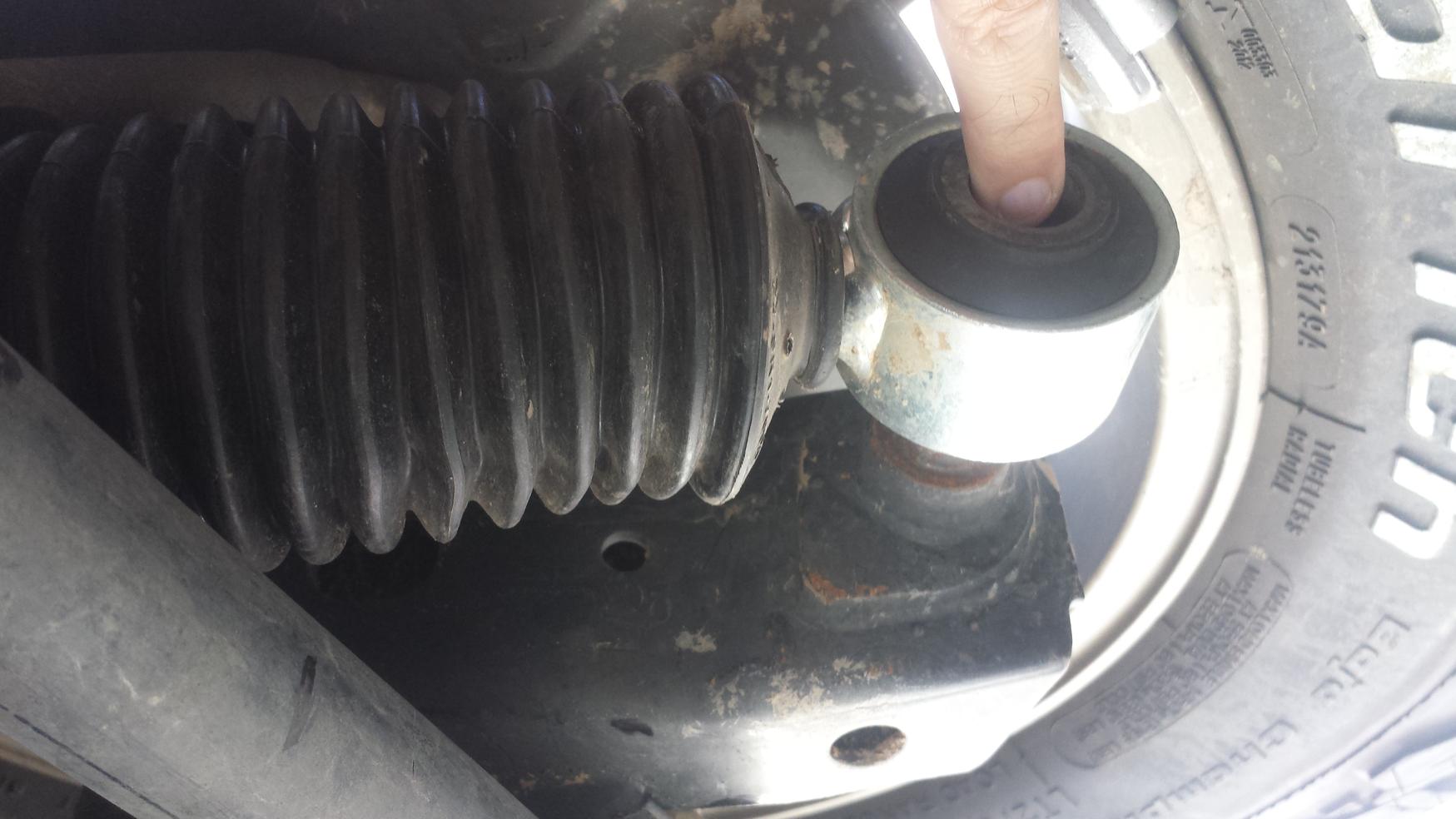

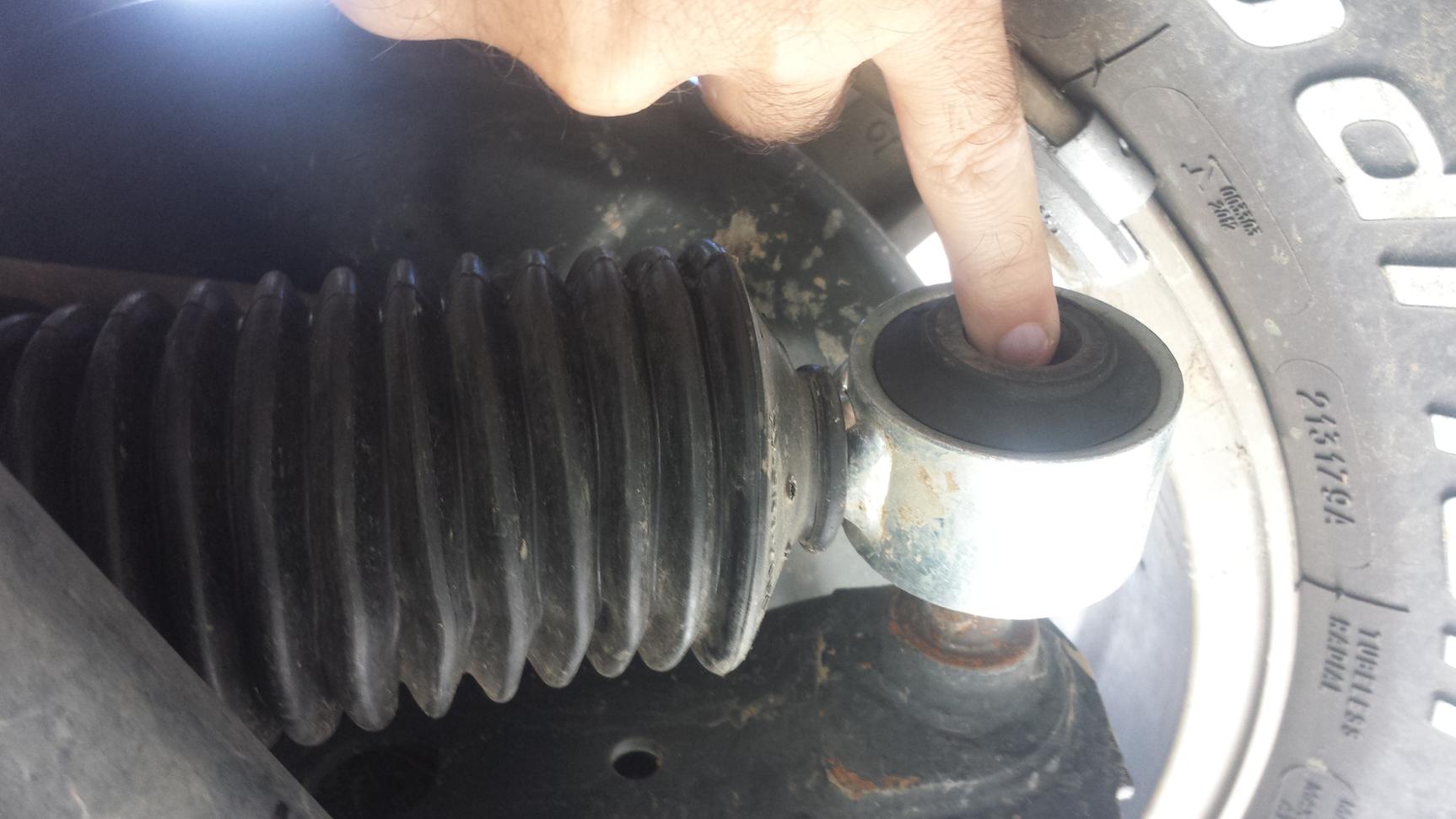

I think he forgot something
dawudih
This is why I hate letting people work on my stuff. Lazy & slopy morons!!! And this was a certified Toyota technician in Katy, TX...Not only did he forget the bolt, which is not unheard off, but he has a bad attitude about it as well.
This might help explain the 3/4" driver side lean that came after the Bilstein 5100 installation.

I work ALOT & have some multi day shifts, so I just dropped it off during one of my 60hr shifts. He did it off the clock at a reasonable price ($340 install & align), so no warranty. Not the most descent man I guess. Wouldn't have posted this if he would have said "my bad, sorry", but he had attitude about it. I'm just venting.
Anyway, this isn't dangerous I think? Part will be here Thursday.

Yeah, it's been about 3 weeks or so. Probably should have checked. Should be safe though right???
It's not safe to have a shock dangling by the top mount, no.
There's no reason you can't get that fixed ASAP. You shouldn't have to wait for a very common bolt and nut. It's very accessible, and you can easily do it yourself in your driveway. Borrow a torque wrench - make it happen. For goodness sake, don't drive it any more like that.
