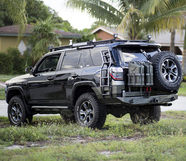

Results were as follows:
If I move forward I'll post up the plan, process, and results.

worst case scenario you spend $200 to buy the original wheels from somebody else. I'm curious to see how they turn out. It looks fine on the Jeep wheels. The 4R wheels have a lot more "design" to them.
