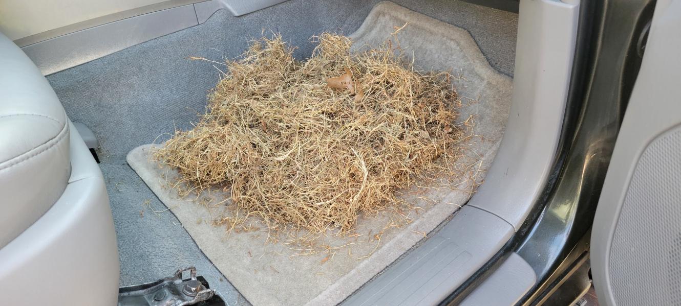

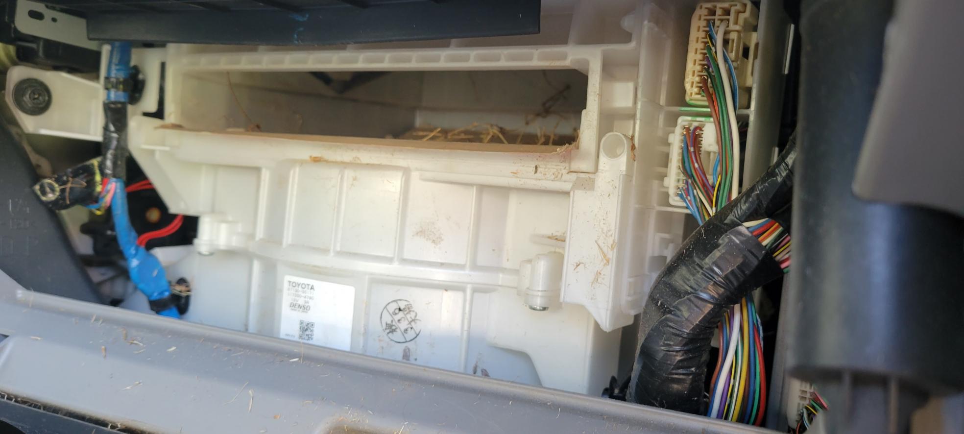

My '08 had critter damage before I bought it. The entire interior harness was replaced, they chewed the seat belts, ate the leather rear lower seat. The only thing fixed was the harness. I was tracing a bad ground and I found whole almond shells in the rt kick panel, the metal area. There were 25 of them. The cabin filter had a nest in it( pic attached ). Critter damage can also lead to mildew and mold. It's not healthy.

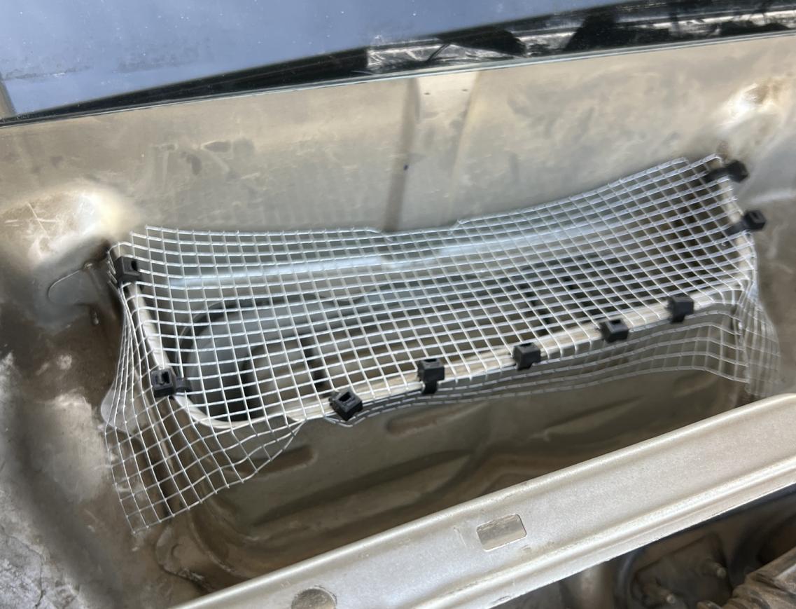

This thread is giving me nightmares. I've been meaning to cover up the cowl opening to the cabin filter with mesh, but haven't gotten to it yet. I had found one mouse poop on the filter. Should probably do it soon.

Thanks to this thread, I closed up that big hole in the cowl. Hopefully that will keep out the rodents. Also still slightly worried about the knock sensor wires. I did get a knock sensor code once, but it cleared itself. Immediately thought a rat chewed the wires.
