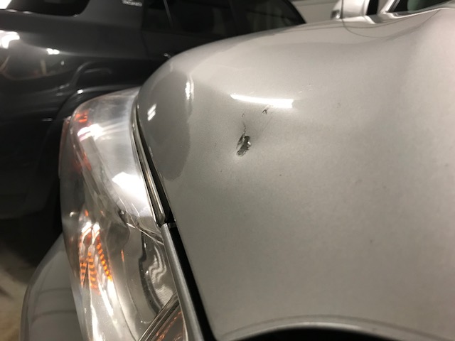

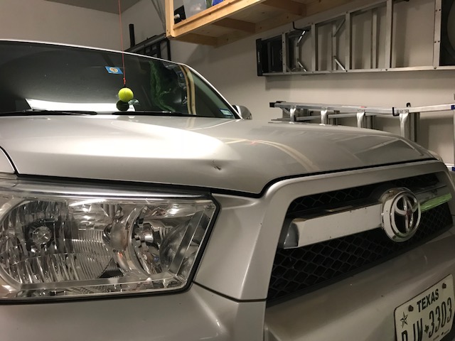

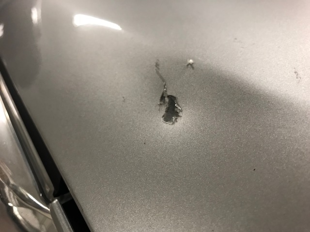

...until this past weekend. I now know why some people have them! Was driving down the road in my wife's 4Runner, and a vehicle in the lane adjacent kicked up a big rock. As soon as it happened, I knew there was going to be some damage.
Short of a new hood/repaint, what course of action can be taken with this? Although it's down to the bare steel, I'm pretty sure the scratch can be touched up to my satisfaction. It's the dent that looks the worst. Think this is something a paintless dent repair guy could get mostly out?
Worst case, I guess I could touch it up and then slap a deflector over it... would've prevented this situation to begin with, haha. :frusty:

PDR the dent and touch it up. Other wise its PDR, body filler and paint the whole hood.
Touch up the paint, and leave the dent.
I think I'm going to try PDR/touchup. I'm trying to avoid hood painting, since I understand they would have to blend the fenders most likely and I'm not looking for all that (not to mention the cost and having non-OE paint).

Me personally, unless your hood is in bad shape I wouldn't paint the whole thing. I'd get a good paintless dent removal guy to work on it. Given the dent doesn't appear to go over the hood crease they may be able to work it all out. Clean the metal then touch it up with paint the best you can. Best case you may not need the bug deflector. Anyway, good luck.

Interesting. So it's like a thick film? In my case it may have protected from the scratch, but not the dent. It's hard to see in the photo, but my wife's 4Runner actually has 3m paint protection film (it's fairly thick stuff) and that rock cut right through it. Wonder how much worse it would've been with out it?!
AVS has a bug deflector called the Aeroskin. It sits tight against the hood all around, as opposed to leaving a gap between the hood and deflector. Looks like quite a few guys on here have installed it. Google the images and see if they look like they will cover the spot where your dent is. Definitely seal up the dent before installing it though.
