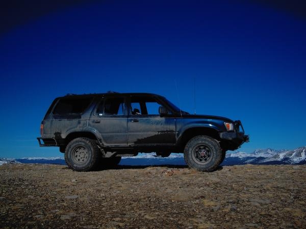

So I have had great responses in the past with my random questions on maintanance and such so here are a few more you all may have some helpful answers for me...
So my 4Runner is a 93 4cylinder with about 96,000 miles on the 22re. I love her thats for sure but since I have lived in CO for this last month, either the cold weather or the altitude it just putting her down in the dumps. I think I got my previous problem with the started fixed (i think it really was/is my battery). Anyways...my question now is does anyone know any tricks to the locks??? It isnt that they are freezing, but some times I just cant get my doors to come unlocked at times!!! It is the weirdest thing to me. Of and if you have any more input on my starter vs battery problem that would be helpful as I still have not had a chance to get my battery tested. (the problem is- my Runner does not usually start the first time, previously I had hit my starter with a bar and then it would start but lately it has just taken a few start up tries and some gas. My battery is a pretty nice, brand new battery but I have heard cold weather will do wonders to your battery). Any help with any of this would be great!!!!
