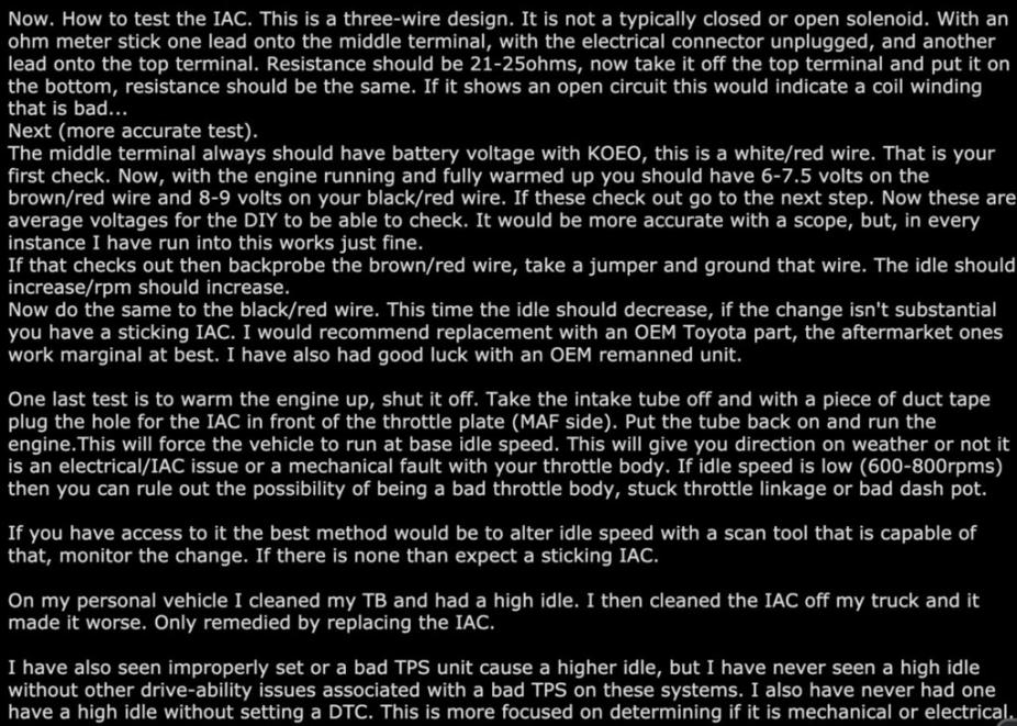

Had a high idle I was chasing after replacing my 98 Taco engine (uses the same IAC from what I can tell as my 97 T4r) and used this to diagnose if it was working properly. Test came out good and figured out I had to have the AFR sensor plugged in to get a normal idle.
