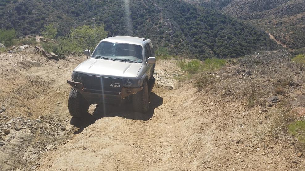

I have shortened my bump stops quite a bit, and i have tubbed to completely clear 35s up front, and then on top of that i have 3" of body lift up front, and they are close to rubbing at full stuff. you can see here. obviously the ride is not as good as something like an icon or king shock though. makes one hell of a budget shock though.
