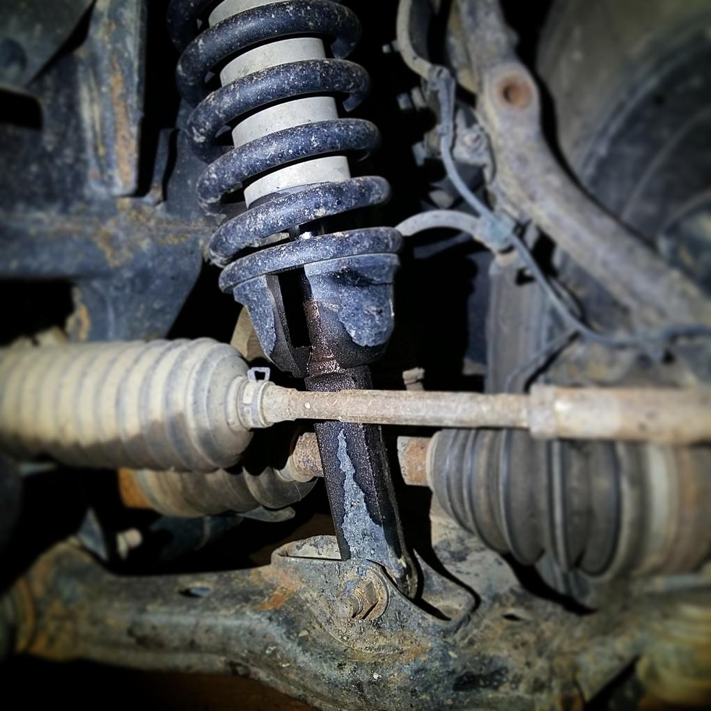

Same fall 2016 batch of 2.5 remote resi's. This is what a leak looks like right?
yes. is your truck on the ground in this photo? your cv's don't look happy, fair amount of rub on the outer fins and the inners are quite obviously touching as well
Thanks for the heads up. Didn't notice that. Is that an easy fix?
FYI per icon support instructions the hose rub and coil/UCA contact problem solution is to adjust the upper and lower cambers to create more clearance between UCA and spring. It's going back on the rack soon to adjust lower arm camber as close to full positive as possible and adjust uppers to 0 or slightly negative overall camber. Hopefully that works and within spec and maybe it'll help with the cv boots too.
