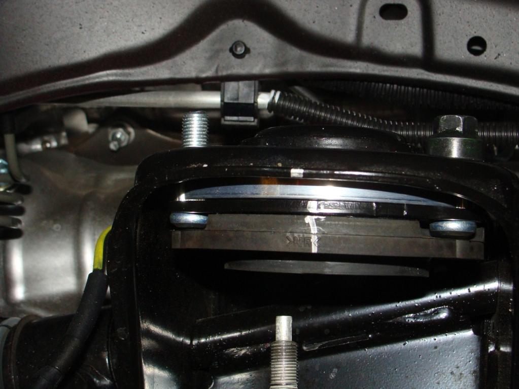

I thought the spacer goes above the spring/strut assembly. How does that preload the spring?
It depends on the manufacturer. Some go on top of the assembly, essentially retaining the same ride while others require disassembling the CO and do pre-load the spring. Some do both.
