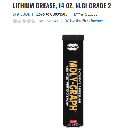

And NO, you don’t need to add any grease to the ball joint as it comes pre-greased from Icon. What I would recommend doing is contacting Icon and see what brand of grease they use. I know it’s a moly blend, but sometimes the grease soap of a particular brand doesn’t mix well with another brand and you’ll have to push all the original grease out during maintenance or you could end up with an oily mess running down your coilovers.
Yes use Li,
Lithium grease on delta joints when that time comes (new are already pregreased as stated by ChrisJHarney) but other than that no issues at all been on for over 12k on my FJ pro suspension.
Sorry to revive an old thread, but I ordered a set of these and was curious about greasing. I just got off the phone with Icon and they said it's fine to use the same moly grease for bushings and delta joints.
Not saying that you're wrong, just curious why you suggest otherwise?
My bushings swelled up and had to be replaced after 3months due to lubing with Moly grease.
I had to buy new bushings from ICON, they would not warranty them due to using the wrong grease, your call.
Thanks for the reply. Weird that they would tell me otherwise, not sure who to listen to.
I guess the guy I talked to had more of a "grease it with whatever you want" attitude, not that he didn't care just that it doesn't matter which grease you use.
I should've searched elsewhere a little more, it looks like silicone PTFE is generally recommended for poly bushings so I'll just bite the bullet and use two grease guns.
