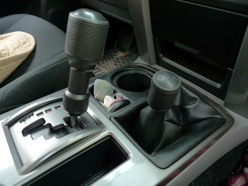

You need to call them and tell them that you need the shorter one, I think it's actually from the FJ. I love mine.

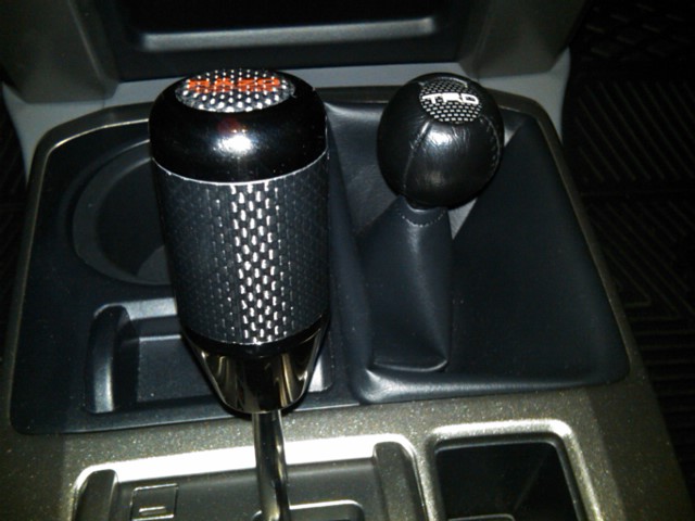

have you considered just getting an FJ gear-shift knob, hamiltonj2w1?

okki I thought about getting a small plastic adapter or something but the point it is I shouldn't have to modify a 75 dollar shifter. I am considering the FJ shifter now it is off a manual?
it's weird. in the parts catalog for the 2010 FJ it's listed as "auto trans manual trans" so i assume that means it's for both. i should have mentioned before that the shaft is a bit too long (just like the Icon one) so i just took it apart and trimmed it ~1/4" to fit. it's a less expensive part, but you may not want to do that as you mentioned. it is pretty trivial, however, in view of all the wrenching you've done on your rig as of late! :D

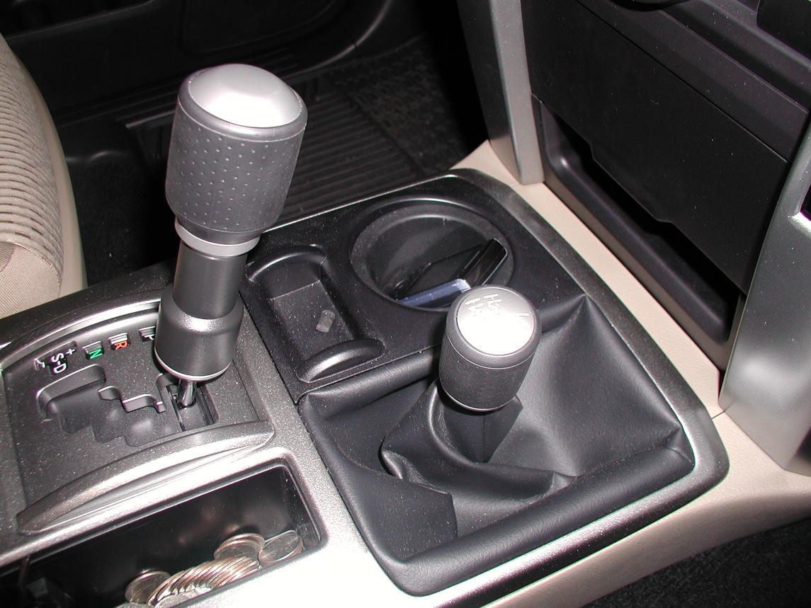

I just replaced both of my shift knobs.
Razo 400 g
TRD black leather

thanks, i really like the FJ gearshift too; way more ergonomic for S-mode shifting, imo. got the idea when i was poking around a TT FJ while picking up my Trail this march. i had my first mod queued before i even signed papers! (second mod, i suppose; had the dealer install Duratracs pre-delivery.)
to your question, the shaft of the FJ knob is a bit too long so if you screw it on tightly "as is" it will bash the plastic in the shift gates. to make it fit properly i took the knob apart and cut a small section of the lower center portion out and then epoxied it back together. it looks stock and you'd never know the knob was mucked with.
you could also get an adapter, i suppose, but then the knob would sit a little higher.

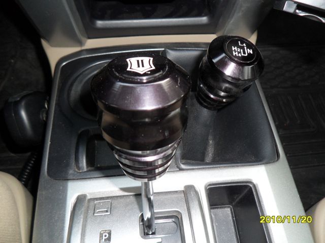

Picked-up a pair of knobs on eBay (with the metal look). Fit perfect, except for main unit being too long as discussed.
I simply dropped an eraser head from a pencil in the shaft and it tightened up just fine.
Looks and feels amazing - Highly recommended...
