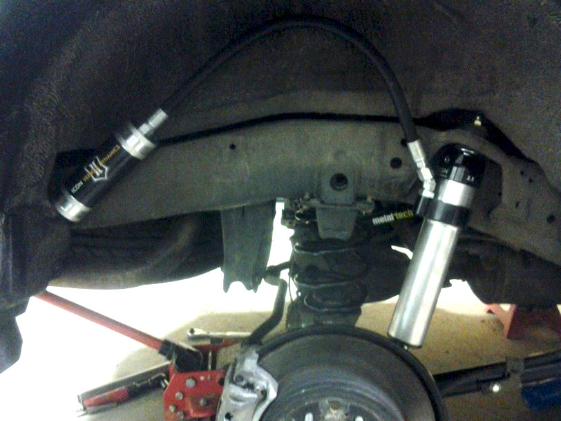

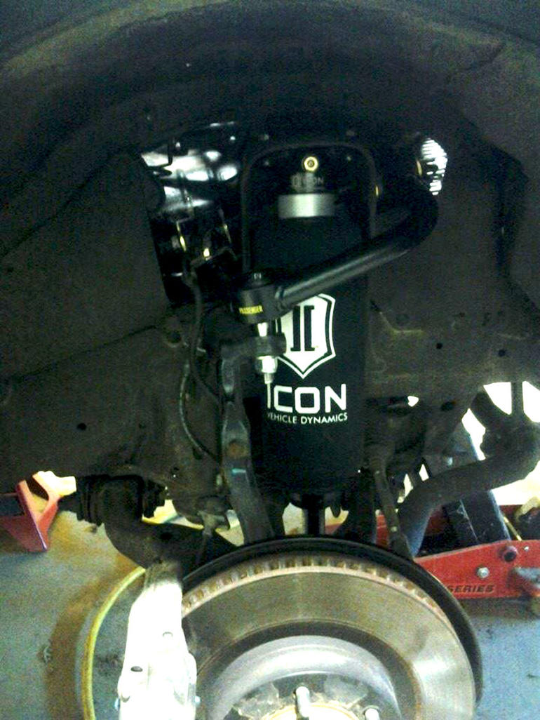

can you please post a couple more pics of your setup? did you get the CDC valves, btw?
CDCV valve, :lol:
I'm workin on putting some albums together but here's a couple. I didn't end up getting the CDC, actually ordered the old piggy backs but apparently they were discontinued? and got these instead.
The pic doesn't show the res installed, it ended up on the frame in the pocket just above/behind it much like the stock photo on icons site. Gotta credit Jeff at Wicked Trail Products for the pictures, they're posted on FB somewheres

looks great. nice thing about the remotes is that they can be upgraded with CDC valves when they're rebuilt. :naughty:
you really going to run those neoprene boots in New England? i'd think they'd just make things worse; easier to just routinely get a good spray in there at the self-wash bay. i assume you got the IVD coated fronts?
got any more shots of the whole rig as it sits now?
