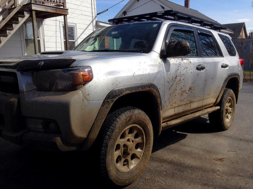

you really going to run those neoprene boots in New England? i'd think they'd just make things worse; easier to just routinely get a good spray in there at the self-wash bay. i assume you got the IVD coated fronts?
got any more shots of the whole rig as it sits now?
my apologies to the OP for going a wee bit off-topic... it remains somewhat germane to the subject, however... :violin:
Yup, figured IVD would be the way to go up here. I'll use the boots on the trail definitely, but you're right and I've heard a few others say the same. Luckily they're not terribly difficult to take on and off. Here's another, so much better when its dirty :photo:
How is it that yours stayed cleaner than mine? …Oh, I think it was that other route I took following Josh where I got stuck for a bit lol.

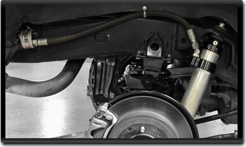

I'm workin on putting some albums together but here's a couple. I didn't end up getting the CDC, actually ordered the old piggy backs but apparently they were discontinued? and got these instead.
The pic doesn't show the res installed, it ended up on the frame in the pocket just above/behind it much like the stock photo on icons site. Gotta credit Jeff at Wicked Trail Products for the pictures, they're posted on FB somewheres
another quick thing re: the new 2.5" rears... the old piggybacks were a 5" reservoir—the new remotes are a 7.5" reservoir; upgradable to CDC valve.
