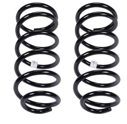

Hey guys, I’ve done some searching lately and been seeing a mixed bit of responses. So I’m looking to keep 2” lift in the rear. Right now I’ve got a 1” spacer plus airlift bags (tow a holiday trailer). I have a shrockworks bumper with swing out, home made cargo boxes in the back, maybe 100, lbs of gear in the back at all times.
I originally ordered icon overland springs but now I’m thinking 2.5-3” is out of my realm. I was just about to pull the trigger on some of the 2” icon springs, but then I read of issues of a lean, and people that are loaded up are seeing less than 2”.
Can someone that has a rear bumper and about the same weight chime in and let me know how these 2” coils settled for you? Thanks!
The icon overland springs are stiff. Like really stiff if you don’t have weight. You might not even have enough weight. I took mine out. But I wanted a 3”+ rear coil.
I’d look into dobinsons to see what they have to offer. King also makes springs in about any configuration you want.
I had my 3" ICON overland springs ... They were alittle stiff and gave me the Komifornia rake look. But once I took out my sliding tray replaced it with a 3rd row. It evened it out. Might need to look for something little bit more when I install a metal rear bumper in there...
The ICON Overland springs should be good for you. I have a similar setup and have been happy. I personally don't think they are stiff at all with the weight. I have a full rear bumper and storage drawers in the back with a GOBI rack.

I used to run Overland 3" springs but found them way too soft. Im probably a tad heavier than you are with my roof top tent but even without it I was constantly bottoming out and reverse raked when I was at full trip weight. I still think the OME 899s are really the only good option for folks who have heavy rear bumpers and carry full trip weight loads.

Rear OME Coils are definitely an option to look into;
Part #2889, Medium Load (3" Lift) - Good for about 200-400lbs of aftermarket weight.
Part #2898, Heavy Load (3" Lift) - Good for about 400-600lbs of constant aftermarket weight.
Part #2899, Heavy Load (3" Lift) - Good for about 800-900lbs of constant aftermarket weight.

If 8 went with the medium load, do you think I’d get down to about a 2” lift? 3inches is getting a bit higher than I want. Dobinsons has a 2” spring

It's for 3" of lift for a rig that has 800-900lbs of constant weight. You will be surprised how quickly weight can add up. I also like to keep the rear at a higher height. Its super useful when dropping off of things like rock shelfs for instance.
I went from Dobinsons 701v to OME 899 to Dobinsons 749v.
With all the weight I carry I was finding the 701’s a little soft. The 899’s were great but I missed the down travel variable coils gave me. Attempted to mediate this with some poly spacers, but ended up going 749v when they came out and love them. I have a hybrid extended travel shock with 2” bump stop extensions and rarely bottom out.
I still prefer the predictability of a linear coil like the OME for on-road, but off-road you cant beat the travel of a variable rate.
The Dobinsons will ride tall when unloaded, where as a linear coil will just ride firmer (little tall, but within range). What this means is you may need to look at other components depending on your specific setup, like rear control arms to correct your pinion angle, longer sway bar links, etc, depending on typical ride height.
I admittedly went pretty tall with my build, probably running the 749v’s on the lighter side, but when loaded up for a trip it’s nice and level, which is how I like it.
For what it’s worth, I sold my 899’s to a buddy with no rear bumper, just a drawer system and fridge, and he doesn’t think they’re too stiff. Your results may vary.

The dobinson 749v how much lift are you??? I'm looking to replace my 3" icon Overland springs. As even now I just have a hitch tire carrier and it's already sagging w/ my 3rd row... I would like to maintain a 3" which is level with my 4.5" in the front
I'm still running the Icon Overland 3'' springs with a 15mm Dobinson's spacer on top of the Icon springs. Currently I have about .75'' of rake when unloaded.....but it decreases quick when loaded down, and I want to maintain about a 1'' rake when fully loaded.
I currently have the 701V's and the OME 899's in the garage that have never been installed.
I've been thinking about going straight to the 749V's, or maybe trying the OME 899's w/ the same 15mm spacers, if needed, to get the height I want in the rear.....Interested to see what you end up doing, as well as any further info from [MENTION=96425]JSparky[/MENTION]..
