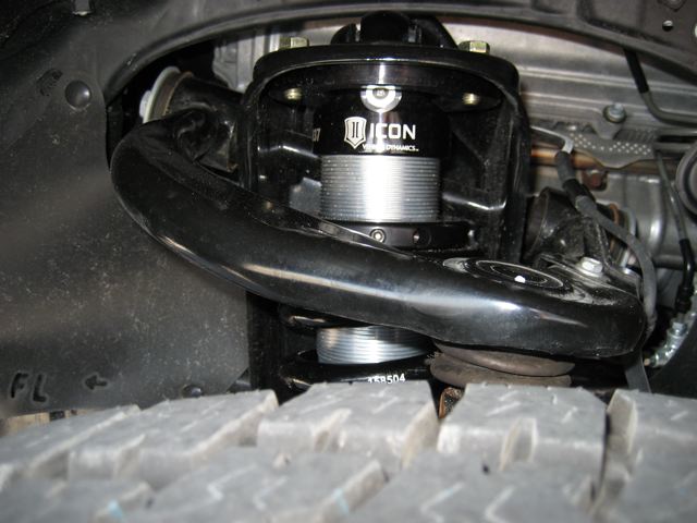

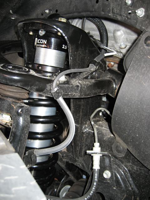

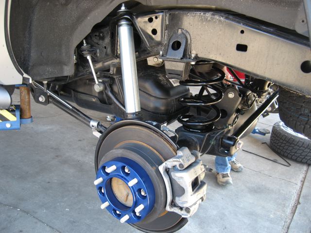

Just installed Icon suspension today. It's perfect! Along with spidertrax spacers.

I ended up with 3" lift front, 2" rear. I left the coilovers the way they came- which was 1 1/4" of thread showing. So I could crank it down another 3/4", but I like the stance the way it is. It may settle down a bit further as it breaks in- I only drove it 2 miles so far. I need to get it aligned now.

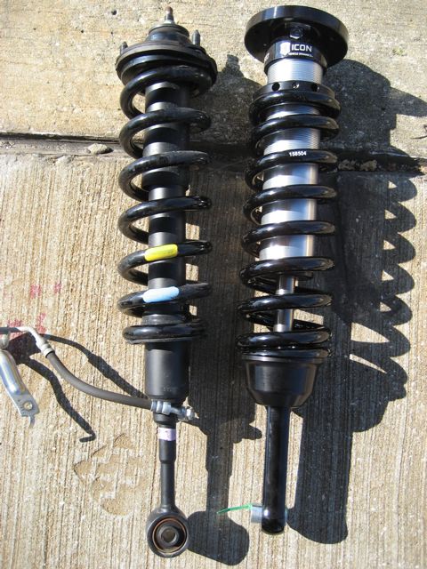

Here's the coilovers compared to stock. Check out the piston shaft diameter!

Were the spacers required or were they just for the looks ?
Not required at all. For looks and also stability- having your track 2.5" wider helps offset the fact that it's riding 3" higher. I had to reposition the front fender liners forward to keep the tires from rubbing. Easy to do, removed the three screws and backings that hold the liner in place, moved the liner forward an inch, and screwed the screws back through the liner. It's very soft plastic and went right in. No rubbing now.
