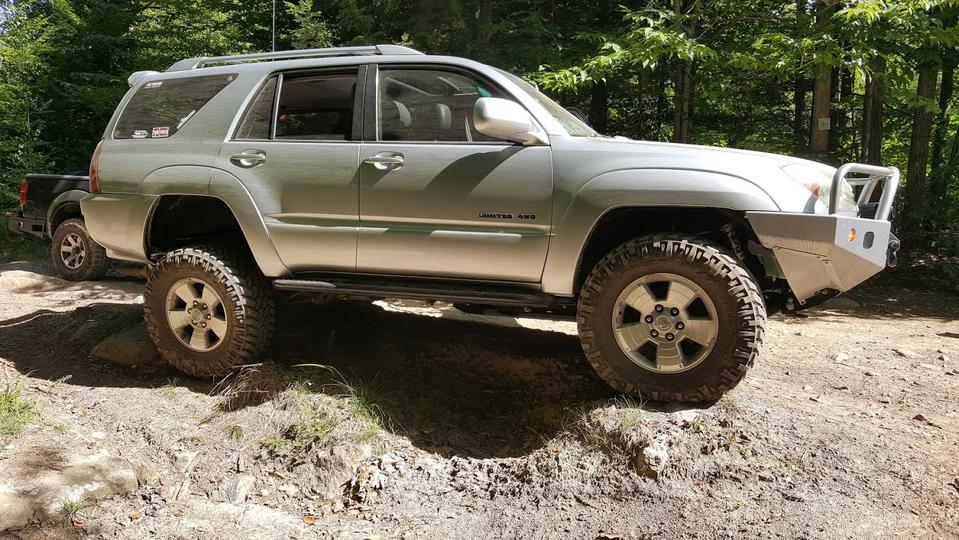

I have the Icon setup with the cdcv I found quite a difference., funny my friend got in and said did I change the suspension he noticed within 20 min of driving ., on the other hand off roading I let my friend drive it during an off road trip and he said " this is like luxury off roading I knew I made the right choice and they adjust quite comfortably.
I have used kings before and agree they are just about the best you can buy. I really want to buy a complete kit but if I have to piece it togethor I will. The only thing I will also be adding is air bags I do tow occasionally\
Swift, truck looks great what size tires are you running?

swift, truck looks great what size tires are you running?
285/70/17
