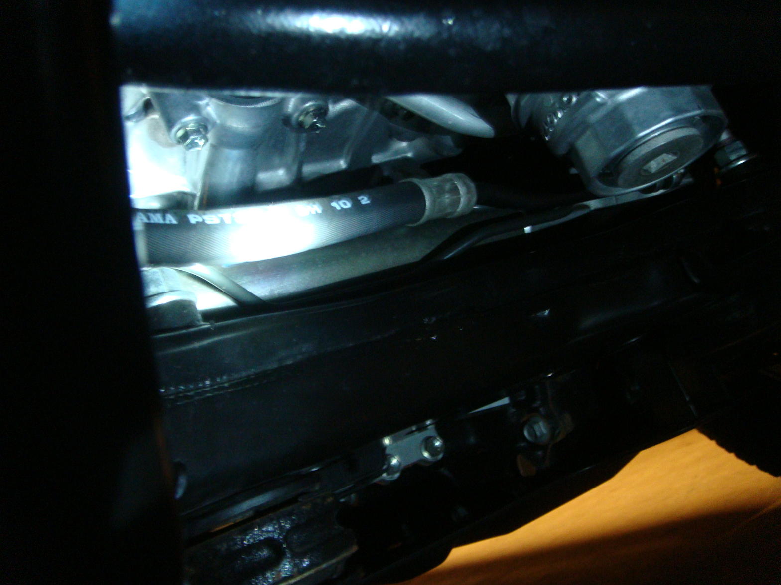

hey guys i'm installing my lift this weekend. As the temperature will be in the low 70's. i will be posting in here as we go. is this the best location for the front jacking point? i did a search here and saw some diagrams but no pics of the actual location. it's getting dark here and this is the best picture i got. basically it's in front of the oil filter housing is a crossmember.

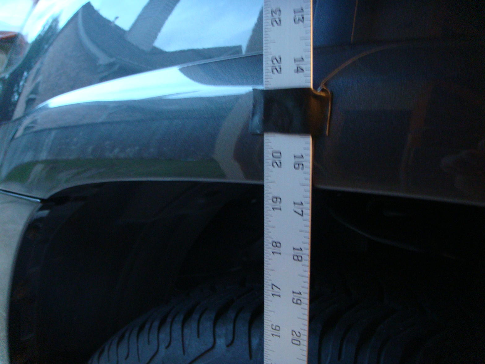

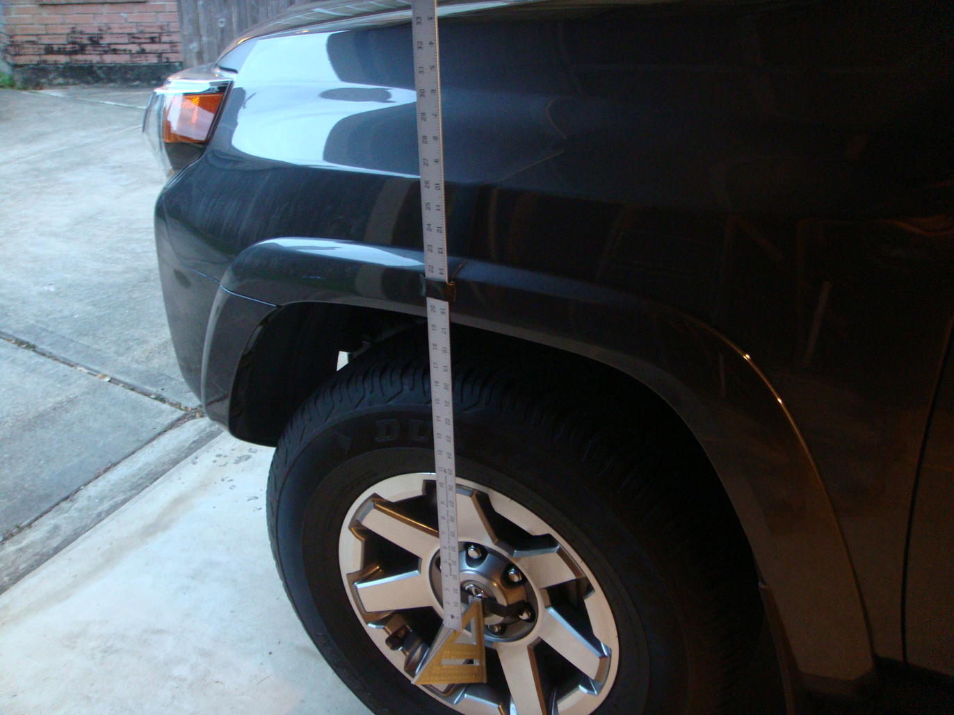

also took some stock measurements front center of hub cap to fender line. front driver 19.5 front passanger 19.75
rear driver 21.25 rear passanger 21.75

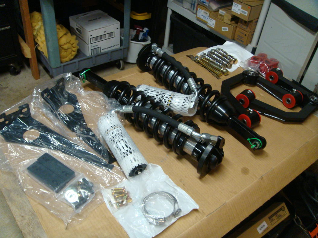

do you have the same set up? the reason i ask is because there are two brackets for the front coilovers. those brackets are used only if you have the kdss?
Sorry mine was a toytec ultimate. Not sure what the brackets you are referring to are for.
