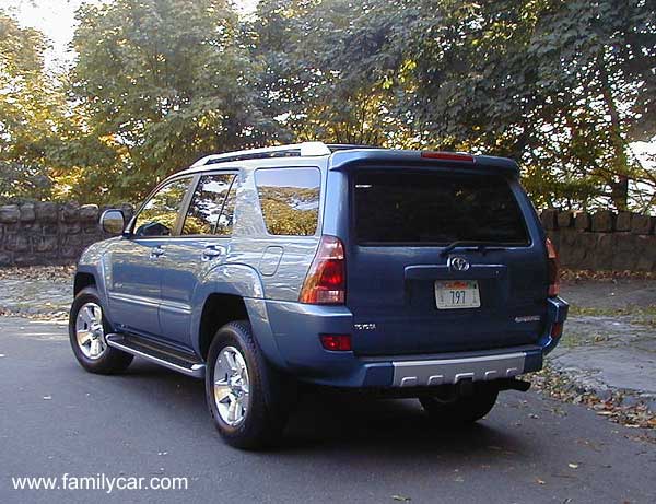

2) I am open to other ideas for what to spend my money on... thoughts? Don't come with "Plasti-dip"... I like my truck's faux-chrome appearance and would like to spend my money on something that would improve something performance-related. If anything... appearance-wise, I'd like a little more faux-chrome. The two-tone rear bumper that some have looks pretty sweet to me. See:
