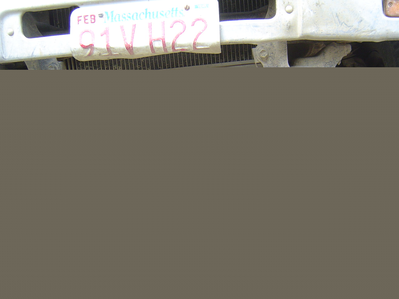

There are several different ways tell the differance. If you see CV shafts and boots, IFS. If you see A arms, IFS. If there is a crossmember below the axle, IFS. If there are leaf springs, then it is a straight axle. Below is a pic of my truck with IFS. People have big misconceptions about IFS. A lot of hardcore offroaders will laugh you off a trail if you are running IFS. I run IFS and can run through anything, plus I get a nice ride on the road. It is a little more complicated, but it is no big deal if a truck is IFS. There are going to be several people who disagree with this coming up below, but I have no problem with my IFS.

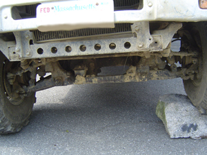

Here is a pic of my IFS. There is nothign wrong with IFS, unless you are a rock crawler, then it becomes an issue of traction. The IFS loves mud, it loves sand, it loves trails in general. The only thing that IFS is not the best at is rocks. I get laughed at when i show up with IFS by some people, but it isnt always the equipment, it is the driver as well. I can handle the IFS well and it will go anywhere that a straigh axle will. hope this helps, Sam.
