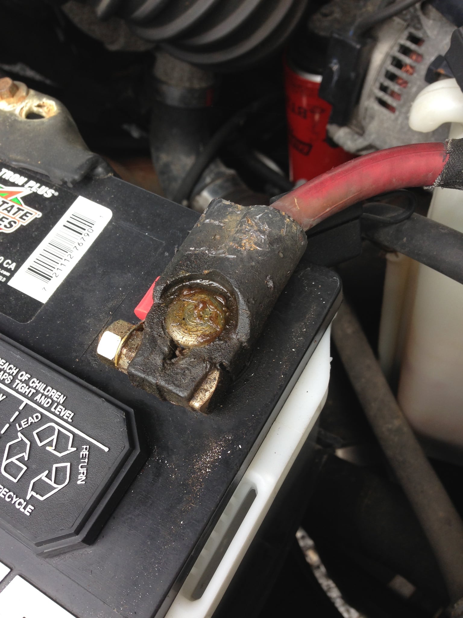

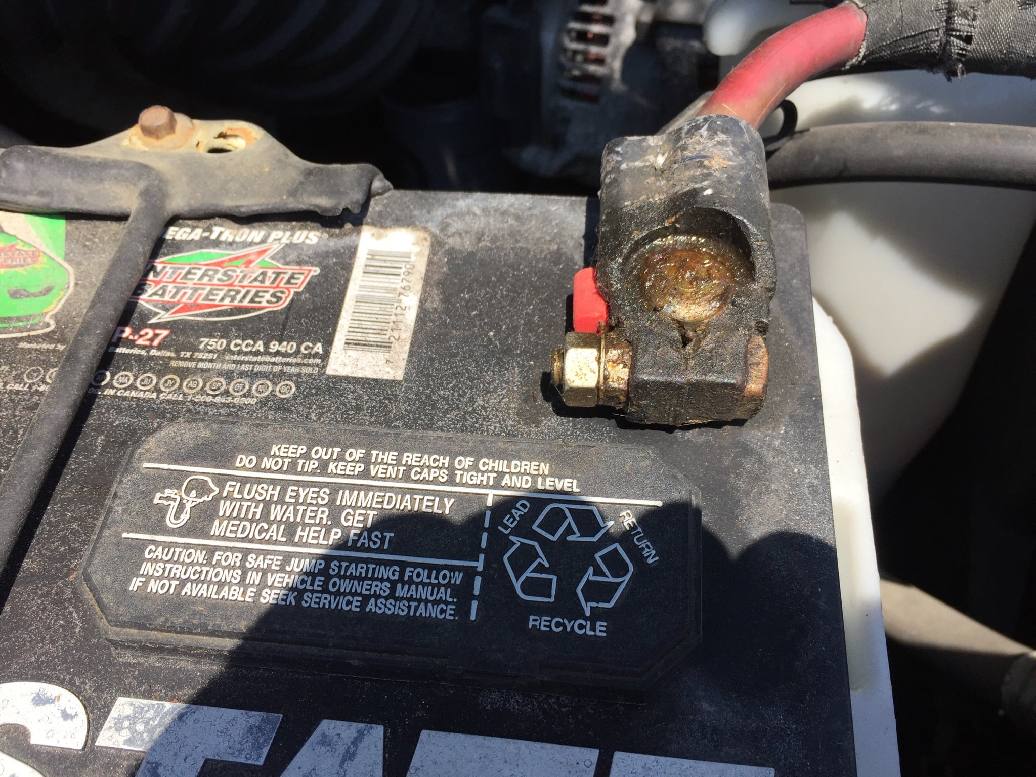

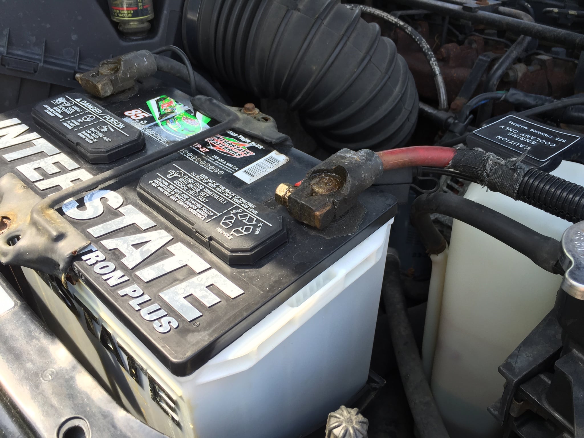

I use an anti-oxidant grease called nooxide. It's a conductive grease. Where I use to work we used it in the manholes for the corona drains on our high voltage. If it can keep those clean while under water it can stand up to most anything. I use it a lot in battery terminals and all grounds.
2013
2016 same battery and terminal before cleaning.
2016 after cleaning engine bay with a citric cleaner.
