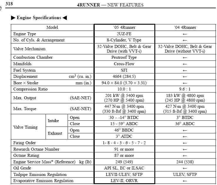

Would the 05 V8 be different? It has a 10:1 compression ratio.
I thought the 2005 V6 was 10.0:1 and the V8 was 9.6:1. If this is true, the V8 definitely don't need super unleaded gas. Can somebody confrim these numbers?

2005 V8's indeed went up to 10:1

I can.
