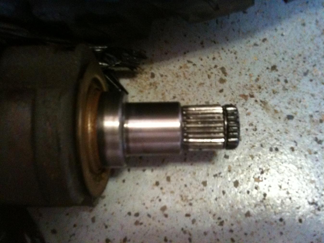

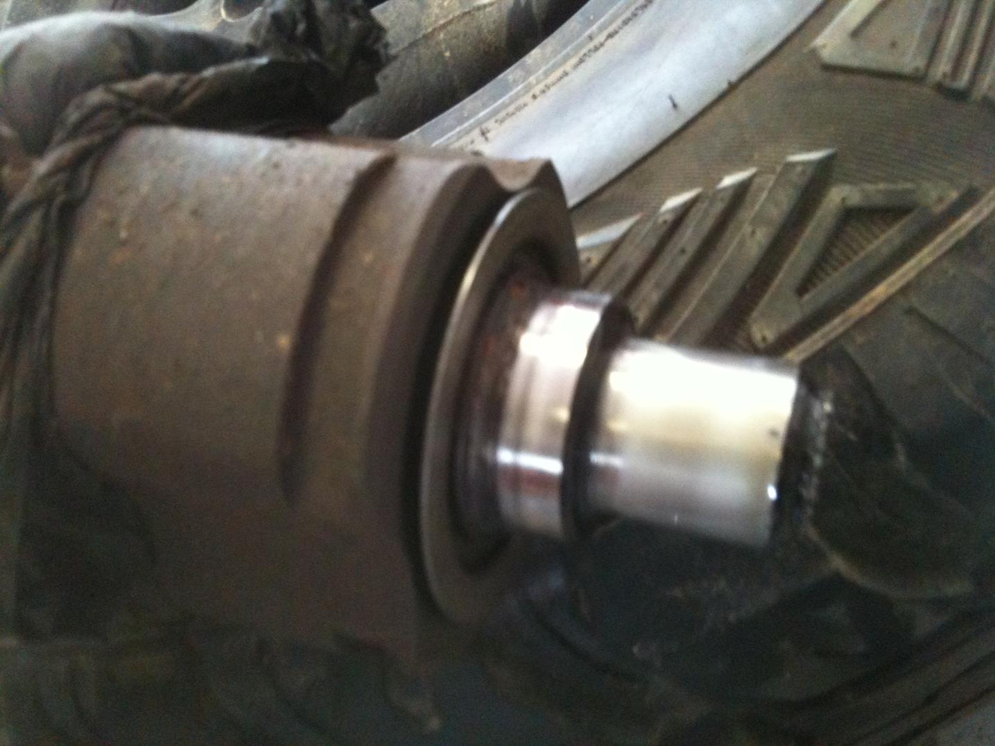

Prize goes to the first one that can tell me what's different about these two CV's!
Bonus round- how the hell do I get it out?

undo the rest of the outer hub and drive it through just like you would do with changing any other CV, you undo pull the wheel off, pull the rotor and the end cap on the hubs pull off your axle nuts then the bolt in the end, remove the C clip on the spline and you can now either push it back to in or on out and you should be golden... clean it out good in there to make sure any little metal splinters or shavings are out removed and put some new wheel bearing grease back in there and you should be good to throw the new CV in and go...
ok now that i looked at the knuckle i see that yes indeed you did shear the inside spline... FYL lol yeah pull the diff and uh have fun

you could use a string magnet to try and fish that part of the spline out with...or drill a hole in it and thread with a tap and then thread in a long bolt and pull it that way... i know thats easier said than done being axle shaft grade steal...
I don't have a welder or tap set yet. On my list of $hit to get. I'm pulling the diff now but the drive shaft flange is fighting between the bell housing and input shaft on the P/S rack. Lucky me since I'm just gonna pull that rack out no and throw in this one out of my parts truck. Both the rack and diff were out of the parts truck in under an hour. It's a lot easier w/o engine and trans in the way!
