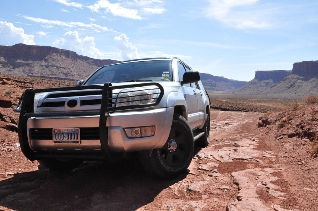

Ok guys, so i'm leaving on yet another road trip in a couple of days. I'll be mostly driving through galveston and southern Louisiana to New Orleans for new years and have decided to go buy some PIAA 510s tomorrow from my local shop and install them myself on my grille guard.
Now i was hoping that someone who has done the wiring for PIAA lights before can help explain how to do the install? From what i've heard it seems pretty straight forward (connect to battery terminals and run to switch) but i'm looking for some pretty detailed instructions that i can easily follow tomorrow (i've never messed with the battery or switches before so i dont want to mess anything up). Below is a pic of my rig during the summer so you can see the grille guard. It's already got holes in it for lights. When i'm done i'll take a pic of the finished product!
