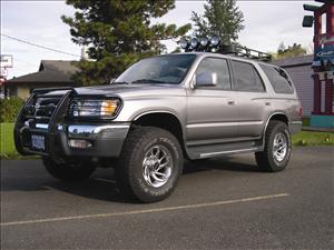

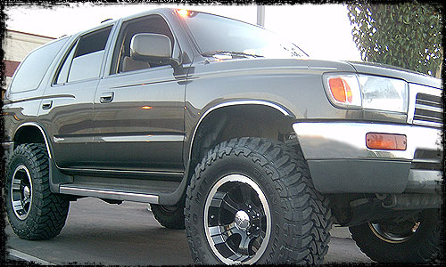

I attached a photo of what looks perfect to me, but I'm guessing it's a 4" lift?! and would probably require much more than I want to do...right now.
That doesn't look like a 4" lift.........kinda looks like my old lift.....

I agree, fightman, after closer speculation that does look closer to a 2.5" or 3" lift, which is what I want anyways. I'm still sticking with the 2.5" especially since I'm getting hell from the wife about putting 17" shoes up to replace the 16" that are on it now. I posted a new thread about this issue, but the short version is that we've heard changing wheel sizing can mess up the ESC/VSC/A-TRAC/whatever the hell it is...any truth to this guys?!
