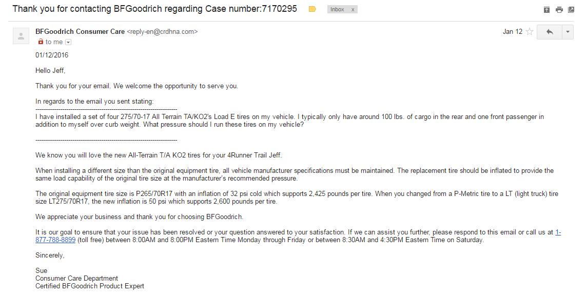

50psi on E-Rated BFG KO2
I simply e-mailed BFGoodrich to inquire about what pressure I should run these tires on my 4Runner. Attached is the reponse I got stating specifically 50psi.

I'm assuming you're talking about a 265/70r17? If would be stoked to average 17-18mpg with 285's. I actually only got 17.5-18.5mpg even with the stock tires pre-lift.
BFG AT KO2's ~ LT265/70R17/C 112 S show the following:
Max Load, Single (lb @ PSI) = 2470@50
I run mine at 44 currently, which would equate to 2173lbs...... am I underinflated?
I'm running my LT265/70/17's at 40psi currently,
maybe I'll bump it up to 50. My compressor is going to hate me when it's time to air back up though.

LT275/70R17/E 121 R
Max Load, Single (lb @ PSI) = 3195@80
3195 ÷ 80 = 39.94
If you are running 32lbs of pressure.....
39.94 x 32 = 1278 lbs per tire (load)
If this is what you are running, my opinion is yes, you are wayyyy underinflated!
I have C rated 265/70/17 and have them inflated to 38 PSI and just did a rotation. Everything looks good and the ride feels pretty good. Sounds like I should be riding closer to 44PSI to match stock load range of the LE though...hmm..I may bump it up and see how it feels.
This is why load range E tires are terrible on a 4Runner. You have to run them way under inflated to keep the ride close to normal.
And there is no way you just picked up 5mpg, give it a few tanks for your numbers to average out.

Additionally I doubt you're really getting 5mpg total (is this game calculated or from the optimism meter?) more importantly your contact patch now it's significantly smaller which means far less grip, increased stopping distance, reduced control/handling, and increased tire wear as the centers will wear out quicker.
