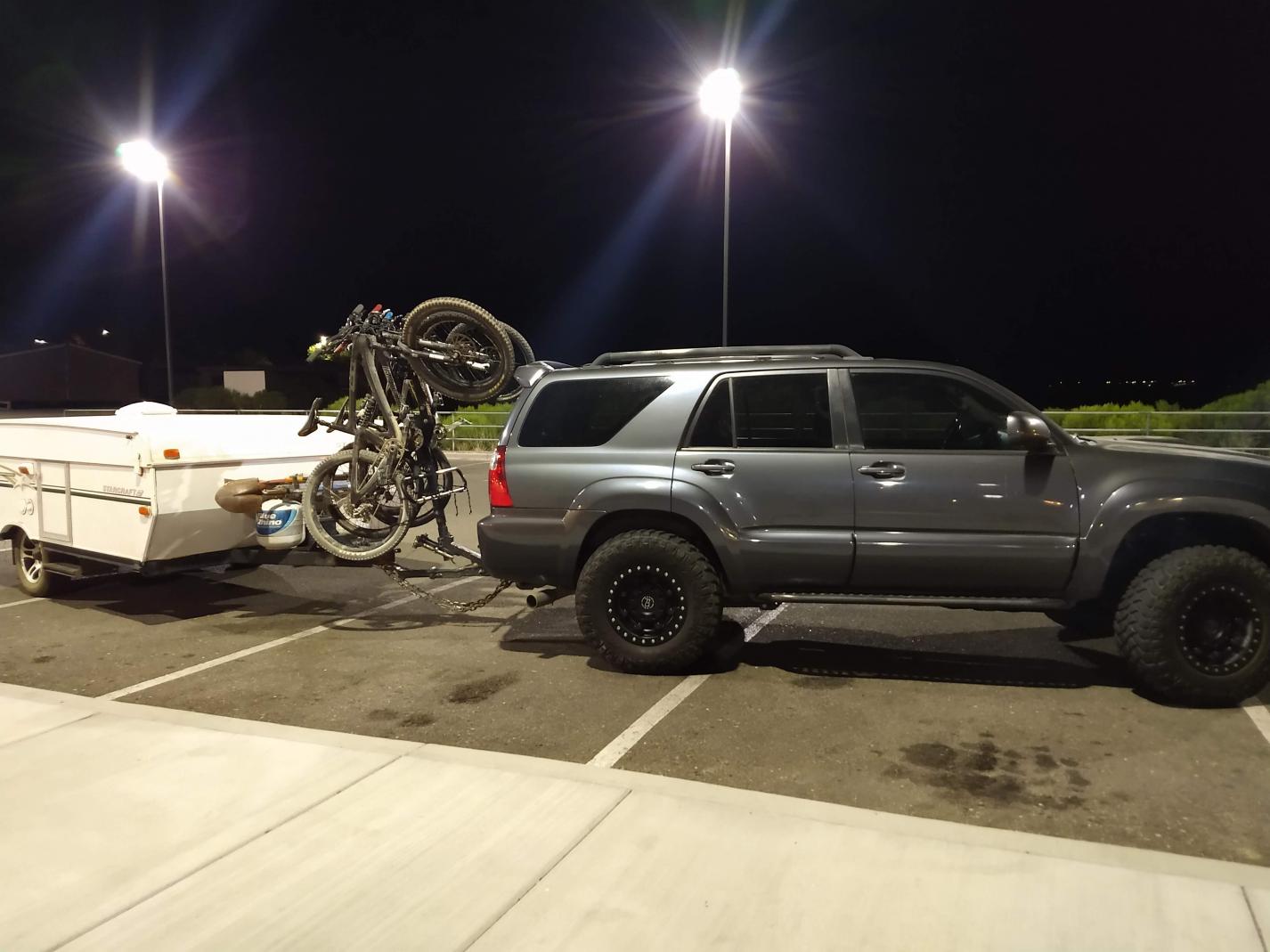

so what you are saying is, re-gear vs reduce rotational weight to get back my towing capabilities back to close to 265 light weight setup.
here is my setup.
here is my setup.
Regear vs. reduce tire diameter. The weight will make a slight difference, but nothing compared to the changed gear ratio due to the taller tires.

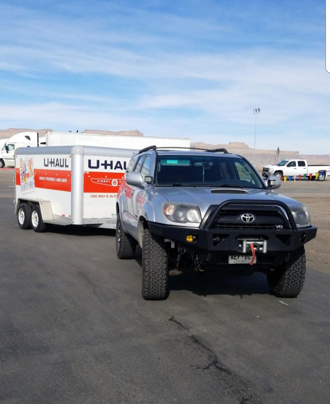

I would definitely agree that gearing is the way to go. I never really towed with stock tires, but I did move back to Denver from Salt Lake after I did my mods with 285/70r17 KO2s in C load. I got the 6X12 Uhaul trailer and filled it up all the way with my motorcycle and other stuff, along with the back of my car. I'd estimate the trailer was in the 4K lbs range. On that drive I had to go up Vail pass (10K+ feet) and also climb up to the Eisenhower tunnel. Definitely wasn't fast, but I never felt like the truck was struggling. I averaged around 12.9mpg on that part of the trip.
