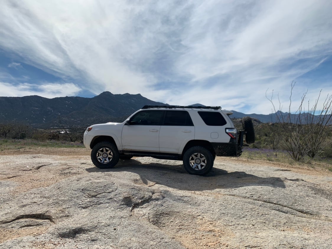

So first I’ll set the scene. 2016 Trail with OME lift, SPC UCAs, 255/80R17 Toyo Open Country tires, Trail Wheels, Spidertrax 1.25” spacers, SDHQ BMC kit. Whew that’s a lot of abbreviations.
Everything was going along pretty good until vanity got the better of me and I decided to put the spacers on. It looks way better with them but rarely rubbed before them.
After I did the BMC, the fender liner mod, and some reshaping of the fender liner I thought I was in the clear, but no such luck. Of course the easy answer is to pull the spacers, and many will suggest to buy wheels with better offset.

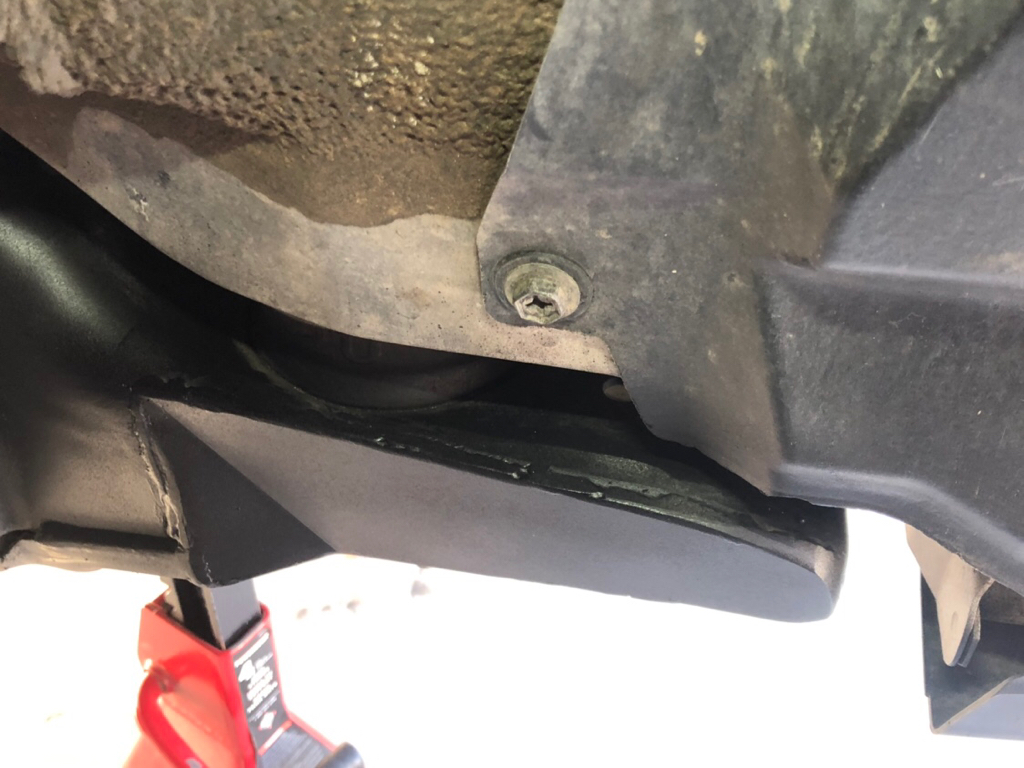

SDHQ BMC plate
Clearance after BMC

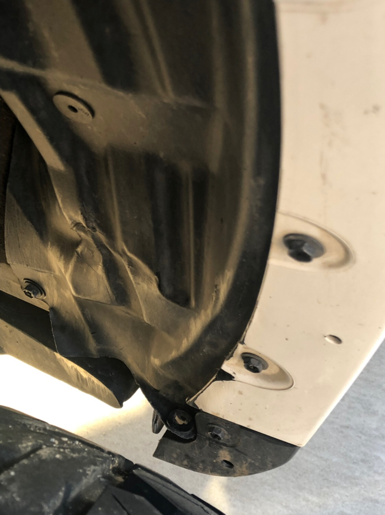

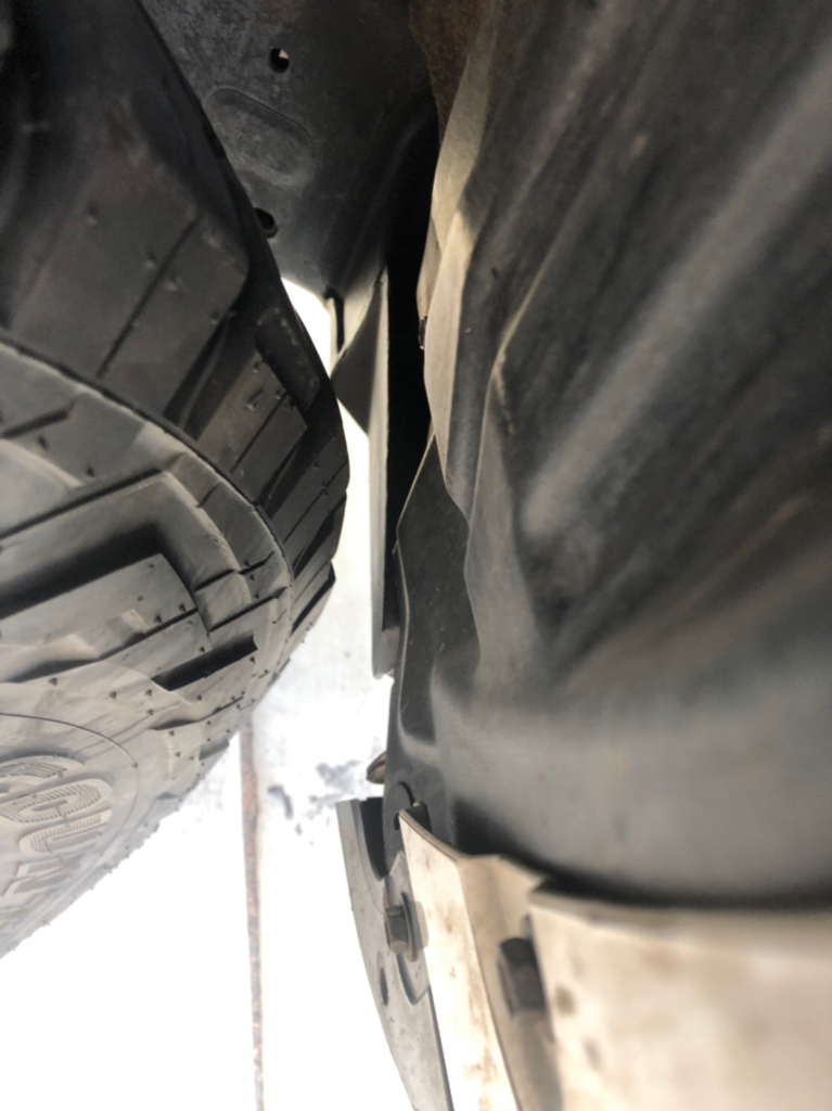

Rubbing on liner, flare, BMC

I haven't tried that yet. Mine didn't rub at all on the daily drive and even on some lighter wheeling. But when I got it into full stuff situations it rubbed pretty bad, as seen by the lack of paint on the fender flare. I'll have to go back and trim some of the liner because I'm pretty sure it won't go back even with heat.

If you already have SPC uppers, go get an alignment and have them max the caster out. I was able to get 3.8 on the driver and 4.0 on the passenger with SPC's. If that doesn't do it, I'd probably go down the path of getting a more aggressive plate for your BMC from Metal Tech and re-doing it.
