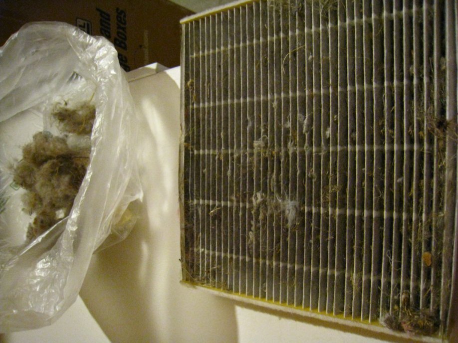

Anyone know what the hell is this stuff clogging up my cabin air filter. All the debri you see in the bag I actually had to pull out from between the dashboard and the plastic frame containing the cabin air filter. Half of it was on top of the filter the other half was hanging down from the dash. Looks like some kind of animal is living in there? I checked for rodent droppings but did not see any.
Only 10k miles on 98% paved road driving.

Looks to me like a rodent's nest. There's a lot of times I pull the A/C filter out of the cars I work on, and I see that. It looks like insulation from inside the car somewhere and a rodent has put it there. We get that a lot in south Florida during the winter months. Rodents like to find a warm place to sleep, and thats a nice warm place. I wouldn't worry about it too much, I've actually seen dead rats laying on top of the filters before. And that STINKS!!!!
It's unanimous. We are all awaiting the "smell test" !! Kidding aside, I once had what I suspect must have been a mouse nest in my air cleaner. There was a kind honey-like resin that was quite possibly the worst odor I had ever experienced smelling.

My money sez you have a mouse/mice in your truck. They pull insulation for their nest, the also pee in their nest.
I'd suggest setting some spring traps in the car and/or under the hood. Put it on a towel, and bait with peanut better. Also set some in your garage. Check daily, keep setting until you catch no more. Do it now, this will get out of hand, they chew wires, insulation, rubber foam, etc. Nasty!
Yep, we constantly see knock sensor wires chewed up on V6 Honda engines due to little rodents making a nest in the "V" of the engine and then chewing on that little wire. I guess they get bored. And that's not a cheap fix and warranty doesn't cover that since it's not a manufacturer defect.

Well took it into the dealer today, and the service guys said it looks like some kind of mouse or pack-rat must have gotten up in there. I asked how the heck could that happen, he just smiled and asked if I smelled anything funny to see if it had died yet. I said no, how about you rip apart my dash and kill the bastrad. He laughed again and said sure we charge by the hour, and if we find it is indeed a rodent we charge you if we find it was Toyota's fault we do not charge you. I said well, when you rip apart my dash and find the rodent I want it's DNA checked to verify that it came from Nagoya Japan!!!

If you keep your HVAC system on fresh air, they can easily get in that way. It's just one big door that goes straight to the filter. But they can also chew their way through plastic and get through VERY small openings. There's no way to tell how they got in, but it happens all the time. If you do put mechanical traps under your hood, for the sake of all us mechanics, at least tell your mechanic that you've put them there so he doesn't get a handfull of hurt!!! :cheers:
