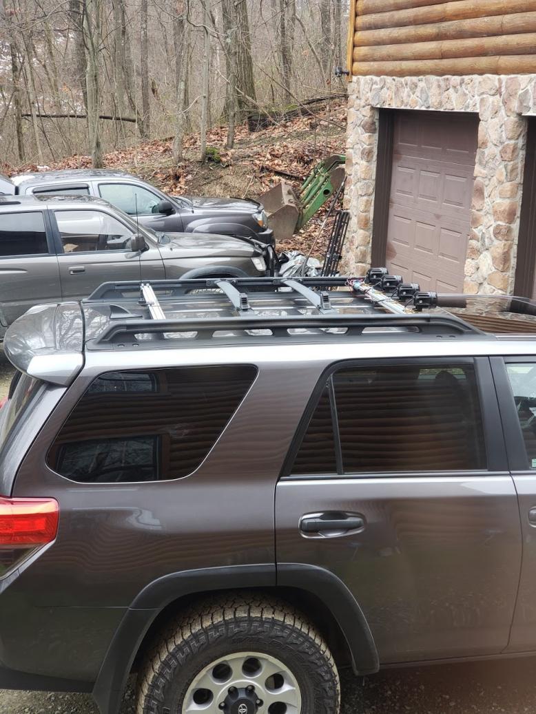

I made my own out of some 80/20 aluminum extrusion and steel channel. They aren't the prettiest thing but they are strong. The attached pic shows 2 of them along with the stockers. I have since removed the horrific lighting wires and am cleaning all that up/painting the crossbars, lol.
I am also looking into making a tubing panel that sits in between the stock rails with aluminum tubing for the perimeter and extrusion cross members. I plan to extend this in front of the sunroof like full length racks so i have a place to mount lighting. Still in the planning phase right now, and raw materials are stupid expensive as well, but hope to have it done this summer.
