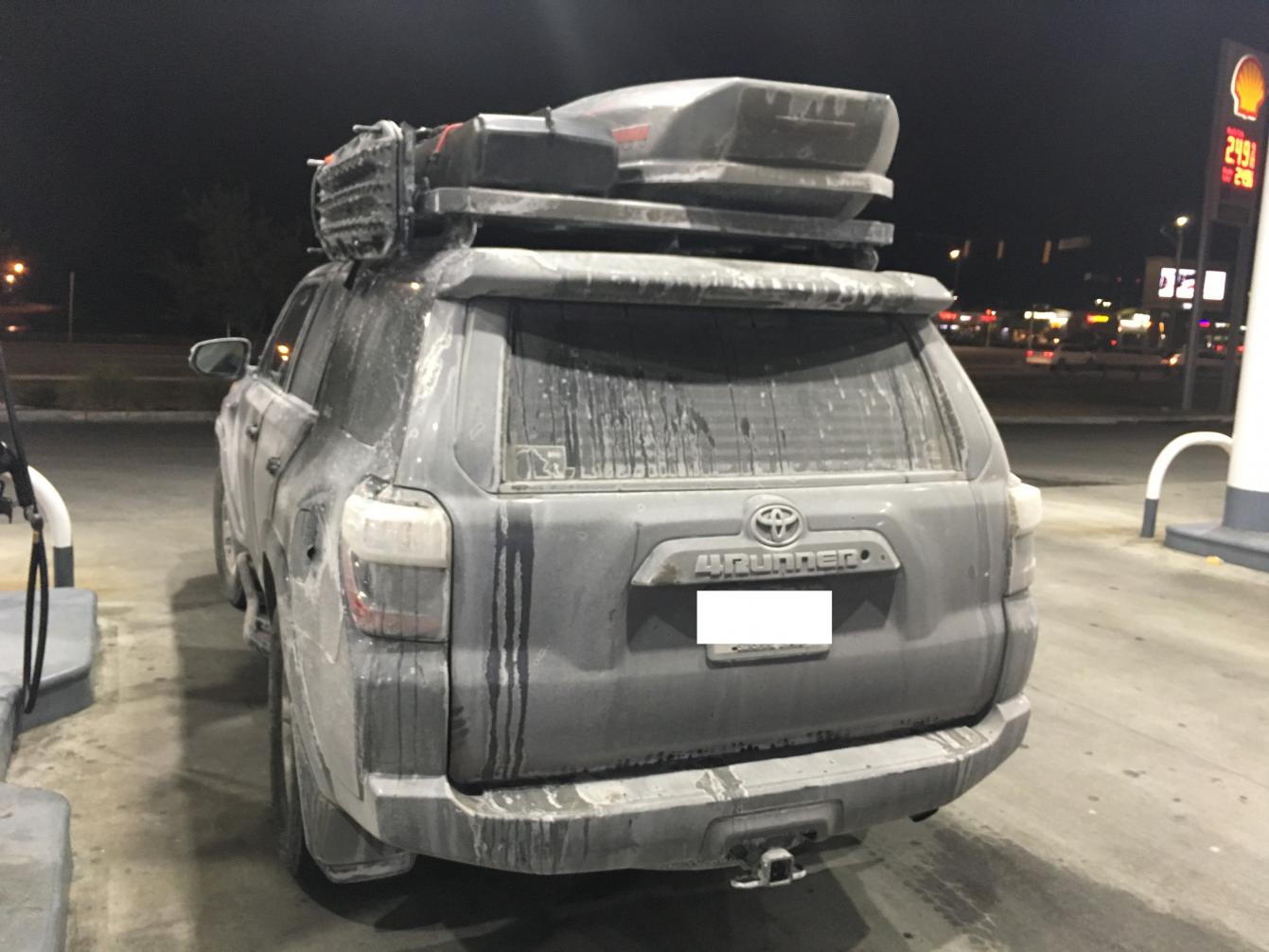

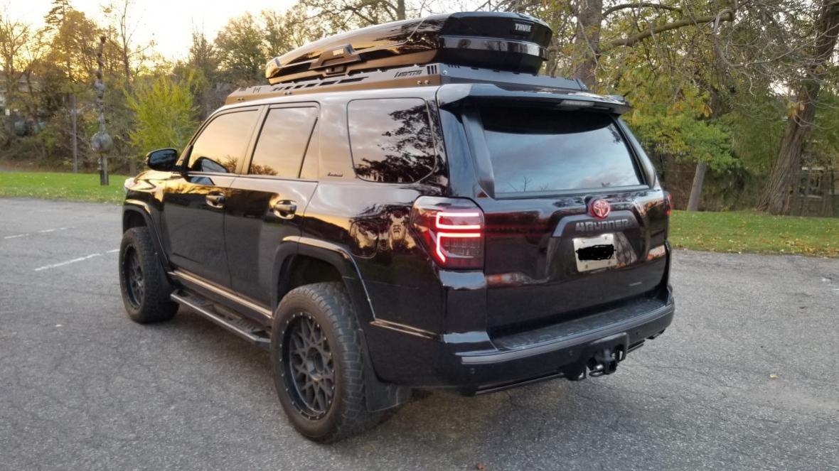

My roof rack was made in Chile and my Thule box fits perrrrfectly!

supratt- Are those factory tail lights and who makes the roof rack?
Niagara Falls. Dont see that to often. I'm from Niagara Falls but family moved to clearwater Florida when I was 14.

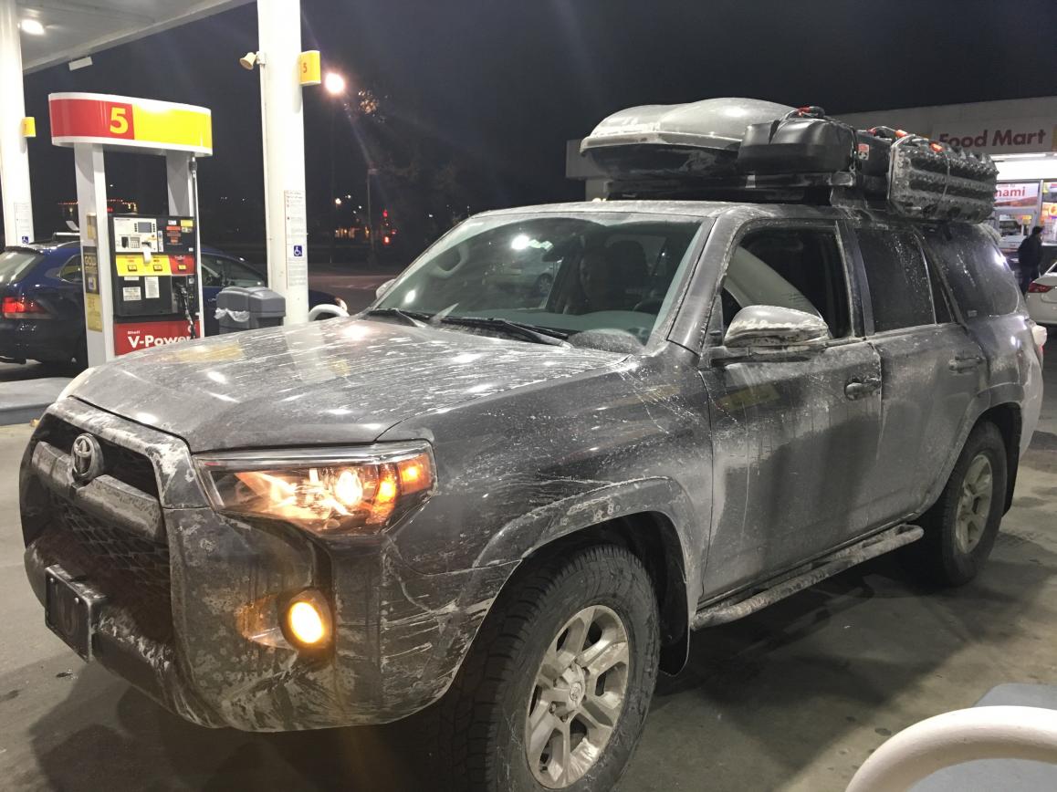

The Yakima Sky Box can grab Frontrunner rails quite well. You will not get them closed around them completely, but I've done probably pushing 10K miles with a box mounted on a 3/4 FrontRunner rack between my two 4Runners without any issues.
For a ski rack I use the Front Runner designed one which mounts up really well (but did have some hardware strip on it that I need to replace).
Agree, we have probably put about 50k on ours. We load our Sky Box with gear and carry the skis/snowboards in a Sport Tube strapped down next to it. Always a long trip to anywhere with snow from South Florida.
