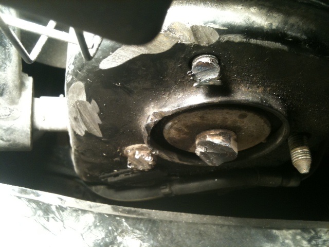

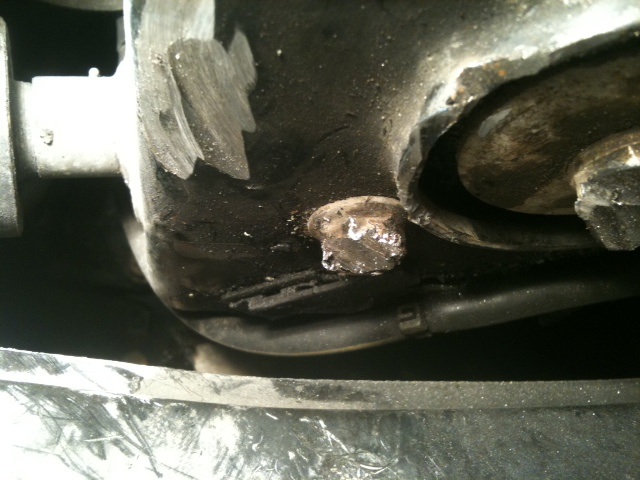

Got the rear done...6 hrs. pretty pathetic I know. I got one of the front finished.... now here is the issue. One of the 3 bolts for the strut on the passengers is stripped to sh!t. I tried cutting it off with a grinder it was a no go. It's worse than it used to be.
The only way I know to get it off it the torch it with a welder. Only problem it that it is not driveable.
I'll pay someone $50 to come torch it for me and then you can leave. I'm desperate here. This is my wife's daily driver and she is out of town until tomorrow so this really needs to happen today.
Someone be my savior. PM me if you can save my ass.
Josh, can you post a pic of what we are talking about here (the clearer the better).
We might be able to help you get that bolt out of there but I am struggling to picture what you got.
You can see which one it is. Sorry they are upside down

Ya i used a 14mm but no go. It was such a tight space...anyhow...I just paid a welder in Craigslist 85 bucks to blow that thing to hell where it came from.
how did that happen? what where you trying to do?
looks like you are gonna need a new top plate, I got them from Oreillys for like 30$, but they had to order them.
I had to cut mine off. Get a dremel with a metal cutting disk. Slice through the bolt as low as you can. Then I used a grinding bit to grind the last bit out. I had to saw the bolts closest to the engine out on both sides. Took me 5 minutes each side.
I didn't have a dremel but I really need to invest in one. I tried to use a 4 in angle grinder and there just wasnt enough space there to fit. If it had been one of the front ones it would have been no problem. I'm just $85 lighter in the pocket, but I stand VICTORIOUS!!
Glad I'm not the only jackwagon that had to resort to this.

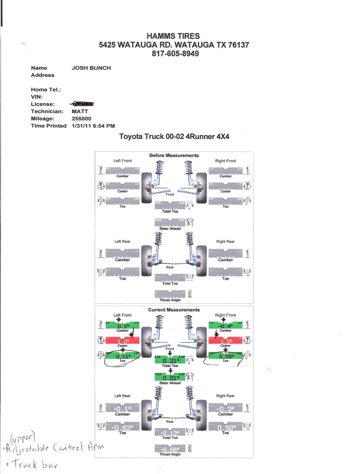

I drilled a hole 3/8 to the middle of the vehicle on the frame side. I went and had my alignment yesterday and they told be I was going to have to get an adjustable panhard bar to put my truck back in line. Also the caster is 1 degree off on each side which doesn't seem to effect driving. The guy doing the alignment says he adjusted it as much as he could, He says I have to get adjustable UCA's to align everything back up. They don't sell that stuff or install it, so they don't have a dog in the fight, and I don't know any better. Let me know what you think.
Also does anyone know where I can find an adjustable panhard bar besides from here: 4Runner - Fully Adjustable Trac/PanHard Bar (1996 to 2002) - $175.00 : Sonoran Steel, Sonoran Steel Custom Metal Fabrication L.L.C. Custom Toyota Truck Parts
Seems a little steep. Looks like a good product, I would just like to save some cash. Especially since I'll have to find someone to weld washers over the original holes so it stays put.
